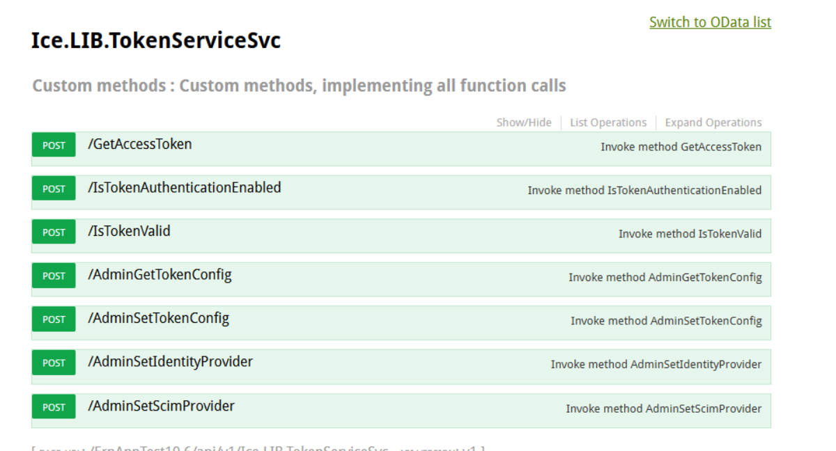

Pretty sure you can using the appropriate request through the Ice.LIB.TokenServiceSvc.
