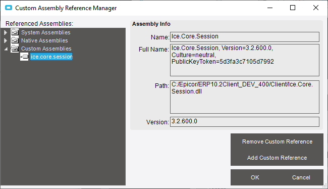

No you go to the Script Editor. Tools -> Assembly Reference Manager
Ok. I did that and here’s my new statement:
args.Row[“ShortChar01”] = ((Ice.Core.Session)(this.oTrans.Session)).UserName;
That actually compiled correctly. Let me test it and I’ll get right back with you.

The difference btw oTrans.Session and oTrans.CoreSession is CoreSession will return an Ice.Core.Session object so you don’t have to cast it where as oTrans.Session just returns an object. Both roads lead to Session object, but one just requires an extra step.
public Ice.Core.Session CoreSession
	get { return (Ice.Core.Session)this.Session; }
