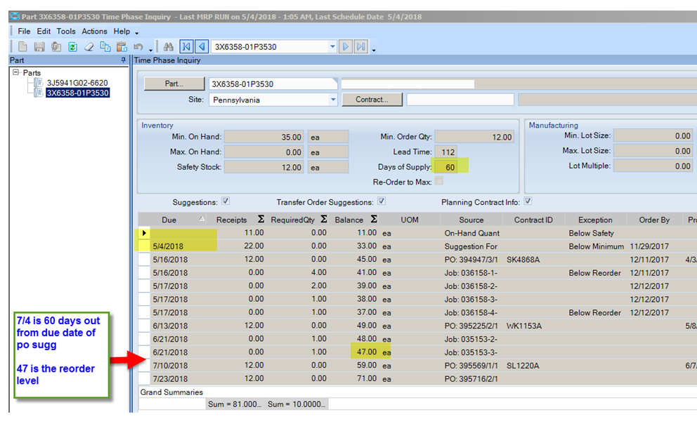

A couple of years back I called Epicor support because I couldn’t for the life of me figure out how it was deciding the quantity to be purchased on a suggestion, more than anything. He told me:
“Talked to Nancy and explained by looking at both Parts I am seeing that it is going out 60 DOS to where needed 3/26 and 5/3. If you look out 60 from that date and at each Parts Min it will be that Qty plus the PO’s out there to make up the safety plus Min. OK to Close Case”
He was talking about this timephase below where we see that the system wanted qty = 22 so that reorder level of 47 was reached within the days of supply.
For our long lead items we have had to push the days of supply out far, past the lead time or the PO’s cut weren’t getting counted. We lock our po dates and quantities because we cut more POs rather than change confirmed ones. We use minimum on hand to store our average usage of the part over the lead time. We use a safety stock calculation that takes standard deviation of demand into account, using this somewhat, but more simplified: Insights Blog | ASCM
We have found that we cannot deal with all parts the same, with repetitive use vs very occasional demand, especially requiring different parameters.
