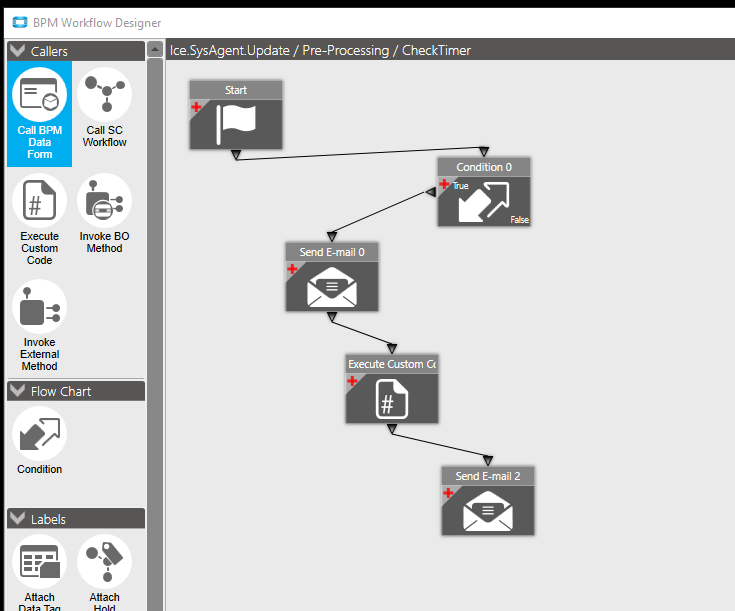

When i say i am a newbie I have never successfully executed any code in BPM Custom Code. What Usings/References do i need to have for this to execute?
I know it is in the sequence of my BPM because both of my emails are firing in this…
Found the issue, needed to retype the “” … in this.PublishInfoMessage(“your message” ,Ice.Common.BusinessObjectMessageType.Information, Ice.Bpm.InfoMessageDisplayMode.Individual, “”, “”);
