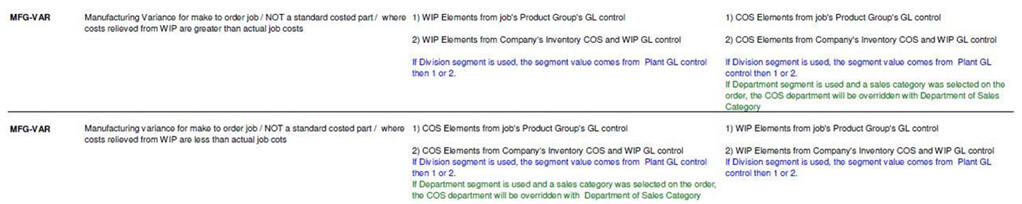

Why can’t the posting engine use estimated costs to determine if it should post to a variance account? I hope I won’t be yelled at (for uploading Epicor documentation), but here is something on MFG-VAR transactions for Non-standard parts from a very old guide on the posting engine.
It states that a manufacturing variance for a make to order job / not a standard costed part (POTF for example) / where costs relieved from WIP are greater than the actual job costs- it would make a debit and a credit to the following accounts (in our case, since we us a product group, it would post to Product group’s GL control).
The issue here is that the amount relieved from WIP for a POTF will never differ from the actual costs of the job because it isn’t relieving based on a standard. However, my question is, why can’t it use the estimate costs to determine how much it relieves from WIP and then post the difference to variance accounts?
