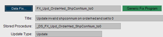

We’re running these daily since our upgrade from 10.2.700 to Kinetic 2021.2.8:

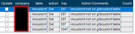

  1. MultiCompanyDirectLog Error - System.NullReferenceException. The data fix action shows ‘imcustcnt not on glbcustcnt table’. Support hasn’t completely given up on this yet, and we might figure it out… But it’s been nearly 2 months.

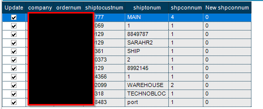

  2. Case Entry error - Ship To contact references invalid value. The datafix changes the shpconnum from some integer to zero.

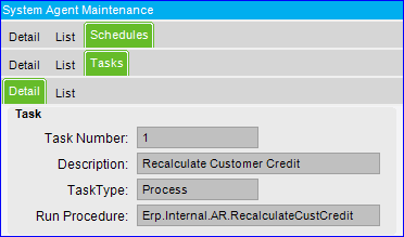

This one you can easily schedule in System Agent Maintenance:

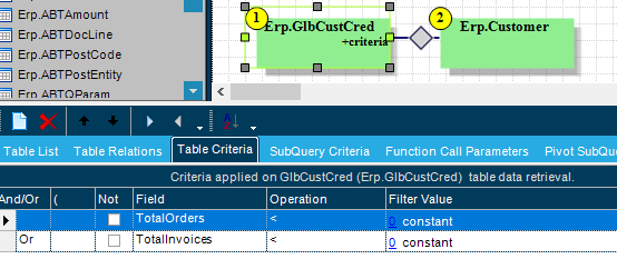

@ScottLepley - Thanks! We have a dashboard that shows customers that need to have the recalc run (querying the GlbCustCred table where TotalOrders or TotalInvoices is negative), which we paste into the Recalculate Customer Credit’s filter tab. It’s a very bad time if someone forgets, and runs it wide open, with over a million customers! Can that be added to the filter somehow programmatically?

Regarding CS0003022656, is there any pattern at all as to why some Sales Orders are getting invalid customer contact values? Are they entered manually or through an integration?
About CS0002975394, I did some quick tests and so far anything related to a Global customer is flowing properly, so no idea why in your case some global customers on the child companies are missing Ship Tos. How are the customers and their related entities created on the parent company and how are they synced?
