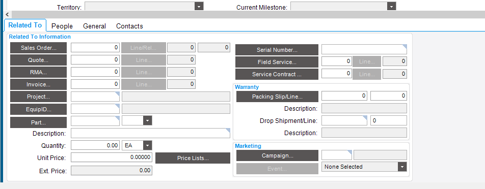

Can you add Job in Case Entry - Related to information?
Hi,
We are using Case entry and would like to add Jobs into Related to information to be able to select and open jobs from Case entry program.
Any advice is appreciated :slight_smile:
Marina,
Doesn’t a job have a part?
Hi Simon,
Job certenly has a part number, but we often have multiple jobs with the same part number so that is why I am trying to bring job number in case entry.
Regards,
Marina
@mg_user HDCaseNum is a field on JobHead. You have to add it to the job entry screen.
Then in the links > jobs tab will list the related jobs.
