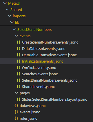

Can you add Serial Number Select to custom app?
Anyone know if it’s possible to open the Erp.UI.SelectSerialNumbersEntry form in a custom app as a slideout?
I’ve got a button created and can get the app to open in a slide out, but so far no luck passing values in (I get an error message and there’s no part info loaded). Before I go down a rabbit hole to only find out this isn’t even possible since it’s serial numbers, thought I’d ask the experts.
Looks like they are importing a shared slider. Not sure how to do that in AppStudio.
This mashes all the layouts, events, DataViews, rules etc into the same App from a AppStudio user perspective. Nearly impossible to untangle the events etc in AppStudio to see how to replicate shared app reuse.
Here is just the init events json, a small portion of what that slider is doing.
MetaUI\Shared\imports\lib\SelectSerialNumbers\events\Initialization.events.jsonc
