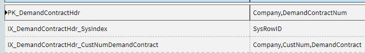

Correct me if I am wrong as I do not know how to check, but it looks like Demand Contract Entry is using the 3rd index below. I would like to be using the PK index. Is this even possible?

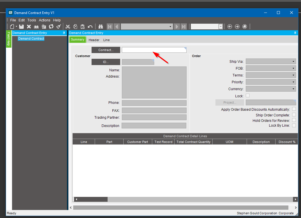

LOL. So, if you look at Demand Contract Entry screen, the DemandContractNum is not shown anywhere. It is like CustNum and VendorNum, hidden in the background. Instead, it appears that the entry screen is using the last index as the DemandContract field and CustNum are the required fields. I don’t understand why they decided to hide the DemandContractNum field as it would just be like having any other transactional number (e.g. Sales Order, PO, Invoice, etc.). Because of this, I wanted to see if I could somehow change the index that they are using.

So the index that something uses is how something is looked up in SQL. If you think of dictionary, you have all of the words in alpha order. You have one index. If you think of a Spanish to English dictionary, you’ve add a cross reference to the other language, but you also have 2 halves. One of them is the English word in alpha order, with the related Spanish word, and the second half is essentially a duplicate of the information, but is ordered by the Spanish words in alpha order, so you can see what the English word is. It’s simply another way to look up the related information. That’s what a second index does. The information needs to be present no matter which “Index” you use. It’s just different ways to look up the same information.

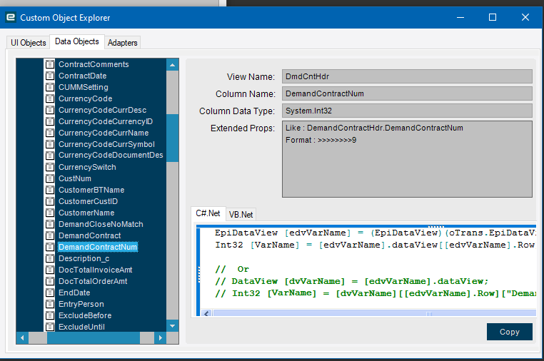

To prove that, if you go into the customization and look at the object explorer you will find the DemandContractNum in the view. So even if this isn’t shown on the screen, it’s still present in the dataview. If you really want to check, run the screen in debug mode and you can see the dataset populated.
Other screens that do the same thing are Customer, and related screens. The underlying link is almost always CustNum, which is the immutable key. The CustomerID is what’s shown, which is a changeable reference. So even though it’s not shown, CustNum is the data that’s being used to relate records most of the time.
So to reiterate, the indexes are copies of the data in different orders to be able to find the related data faster. The indexes that are used for the lookup is determined by SQL at the time of the lookup.

Basically to have a unique ID that is not entered by a human. The thought trail in my mind was that the index was somehow being used to control the behavior of the screen (mandatory fields, searches) and if I could change it, I would not have to build all new searches and such. Basically making the Demand Contract Entry work just like Order Entry.

@Banderson , I split the difference and instead of auto-numbering the field, I set up BPMs to copy the DemandContractNum field to DemandContract.
