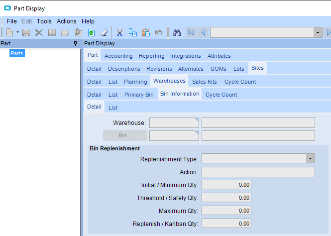

The only thing out of the box remotely close to what you want that I can think of are the BIN Replenishment settings:
These settings are used in conjunction with the Replenishment Workbench, the function of this dashboard doesn’t sound exactly like what you want, which seems more like guidance for the people doing put aways, to help them know how many labels to print, how many empty BINs they need to find, etc.
Even if you didn’t use the Replenishment Workbench dashboard, you may be able to leverage these settings in a custom solution. You have other options here as well. The Part and the BIN allow you to specify cubic volume values, which you could use to help calculate how much space X of part A takes up and how much space you have available in BIN B.
If Replenishment Workbench doesn’t get you where you want I think you are looking at a custom solution.

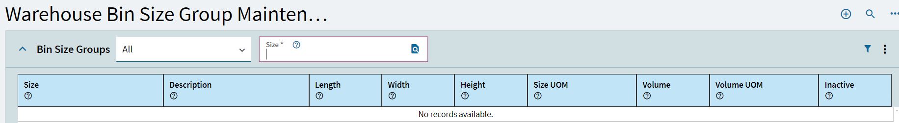

We don’t use it so I can’t help too much…but there is a Warehouse Bin Size Group that you can optionally tie to your bins. If your bins are symmetrically arranged (or at least not too many variations) then this might be an option. Don’t know if it limits what you receive into the bin (edit: or if it’s just for reporting purposes, estimating available space, etc)…

Thanks for the feedback. I don’t know if this will give what we need as it defines the size of the bin itself and isn’t tied to the size of each part. Potentially if we also define a size for each part then it would calculate how many of those parts could fit in each bin, but if we just wanted to check ‘how many bins/labels do I need to report X quantity of this part?’ it gets more complex to implement the calculation.

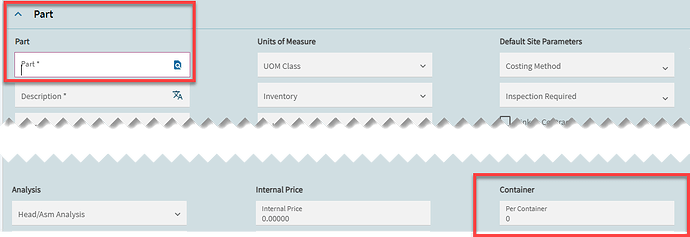

Why not use the count per container.
Main tab for the part. (In Kinetic expand the card to full screen)

Is this something that is intended for this purpose, or is the “Per Container” field meant more for shipping/packaging? I note the “Returnable Container” field that is next to this.
Either way it may work for us but it would be important to know if this would be us repurposing a field intended for something else, or if this is the intended usage.
This would be in a gray area -
The Bin is your container…
I you were to begin to sell by the box, Case, or pallet - you would introduce new UOM’s.
I believe that this will also help you with your label needs at receiving.
AFAIK PartsPerContainer serves no function in the system. To me it reads like it is meant to signify how many parts go in a box. We use this field for our finished goods mostly, for that exact purpose.
Its not a huge leap to go from how many in a box to how many in a BIN, but it feels like you are starting down the ‘not using the field how it is intended’ road again.
To close the loop on this, we went down the road of using Per Container for each manufactured part.
The number of labels to print is the Quantity of manufactured part being completed divided by the Per Container for that part, with the result rounded up to the nearest integer.
