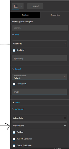

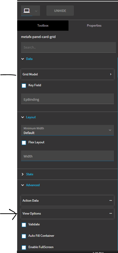

THis grid has 2 views, Costs and Status
With that grid selected I need view Options to get to view( Bottom Arrow)
Drop down choices
Columns is empty…
Since it’s empty, you can click the plus to add only the ones you want to see.
