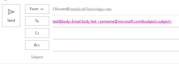

That doesn’t exactly work. It includes everything as part of the TO:

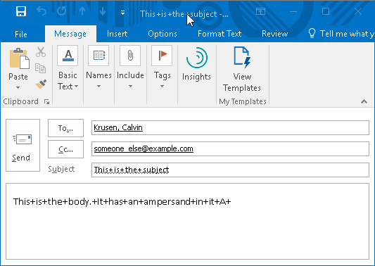

UrlEncode() will convert spaces to pluses (Hello World to Hello+World).
Causing the email to be auto-filled like:
UrlPathEncode() will convert the non-compliant characters to use the %+ASCII (Hello World to Hello%20World)
