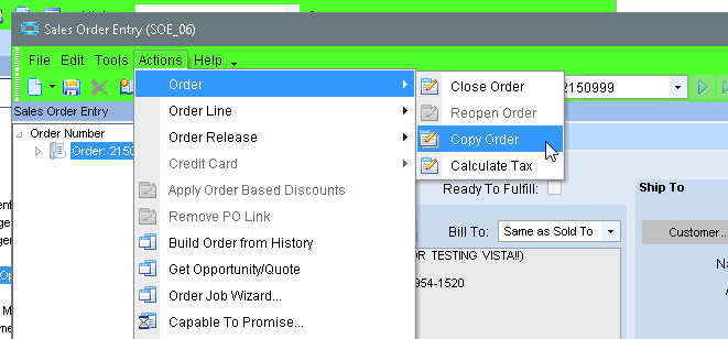

When you select the order you want to “re-order” In the menu select Actions/Order/Copy
It will create a new order with the same lines…

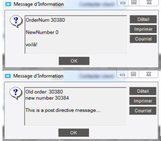

I was too curious… so I tested just a message in pre and post and got the old number in both…
So i am sure you can do what you want here…

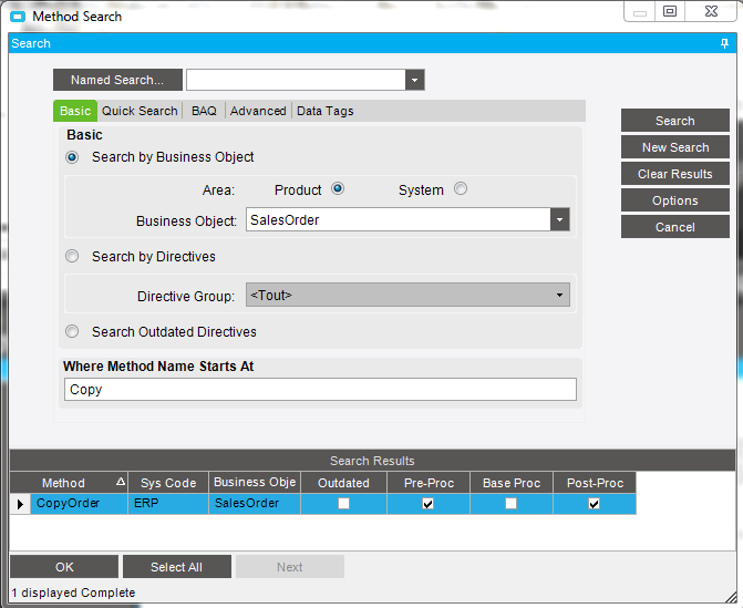

under Method Directive module clic on Method Code… then select like the following:
Click OK.
