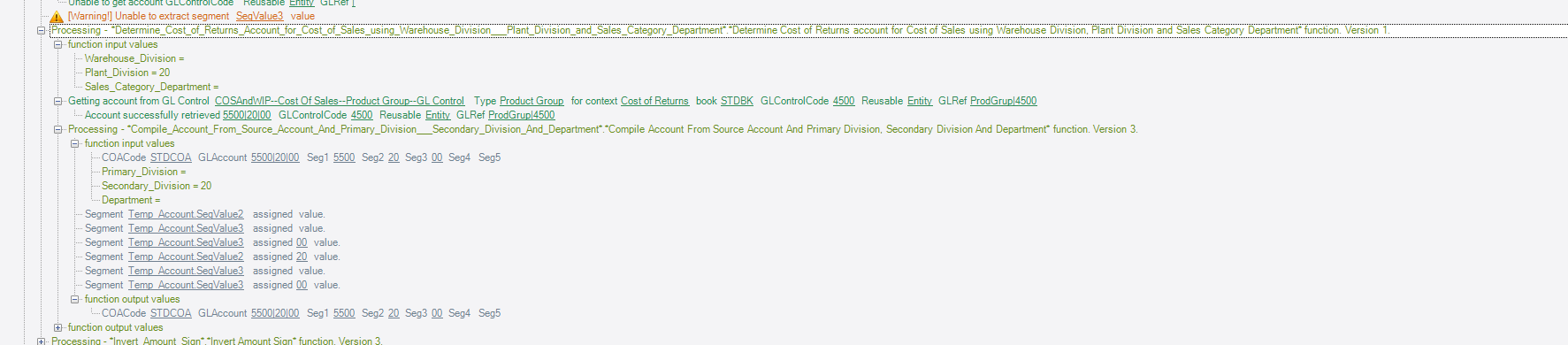

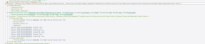

The sales side of the entry seems to be pulling fine. It’s the cost of sales. Epicor had me turn on PE Logger for CosAndWip. Clearly pulling from the product group instead of the AR Code G/L Control. Going to look at setup today as they cannot duplicate on their version of 10.2.600.35. I’m on 10.2.600.8.

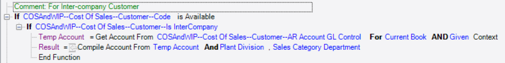

I am not that familiar with CosAndWip, do you mind sharing the booking rule being executed that is pulling from the product code and I can more specifically look at changes there.
I don’t mind at all just not sure what is best to share. Attached is the entire log file. Below is a snapshot of the log file pulling the product group. Guidance from Epicor is to upgrade to 10.2.600.35 as they cannot duplicate the error in that version.

If my analysis is correct this was fixed by ERPS-143870, and later retrofitted to 10.2.600.18 by ERPS-149443.
Before
Rule 1 - Credit Memo = true
Rule 2 - Credit Memo = false
After
Rule 1 - Credit Memo = true AND Cancellation = false
Rule 2 - Credit Memo = false OR (Credit Memo = true AND Cancellation = true)
So now the booking rule executed should call Function “Determine COS Account For COS Detail Using Given Context, Warehouse Division , Plant Division , Sales Category Department” which works as you said(see below).
