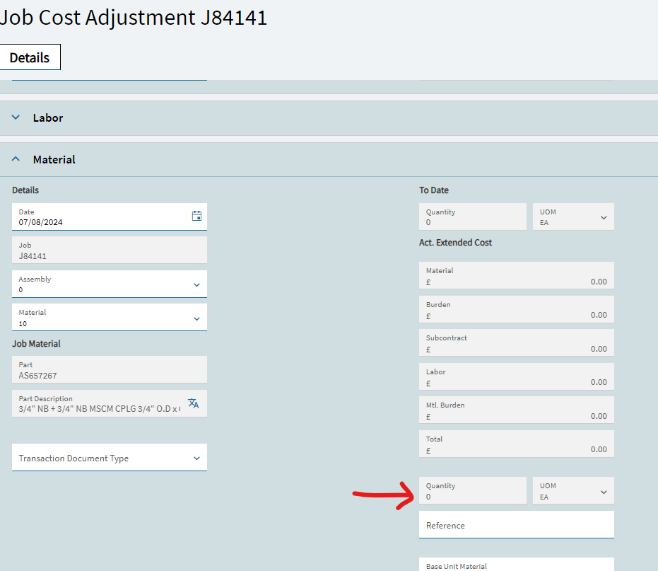

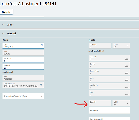

Hi,
I have this material selected on the job adjustment screen. I want to set that a Quantity of 1 was issued, with a cost of 100.00. However, the quantity field is read-only because the material is a serial-tracked part. If I select a material which is not serial-tracked, the Quantity field is editable.
How can we do a job adjustment in this case?
Thanks for any help!
