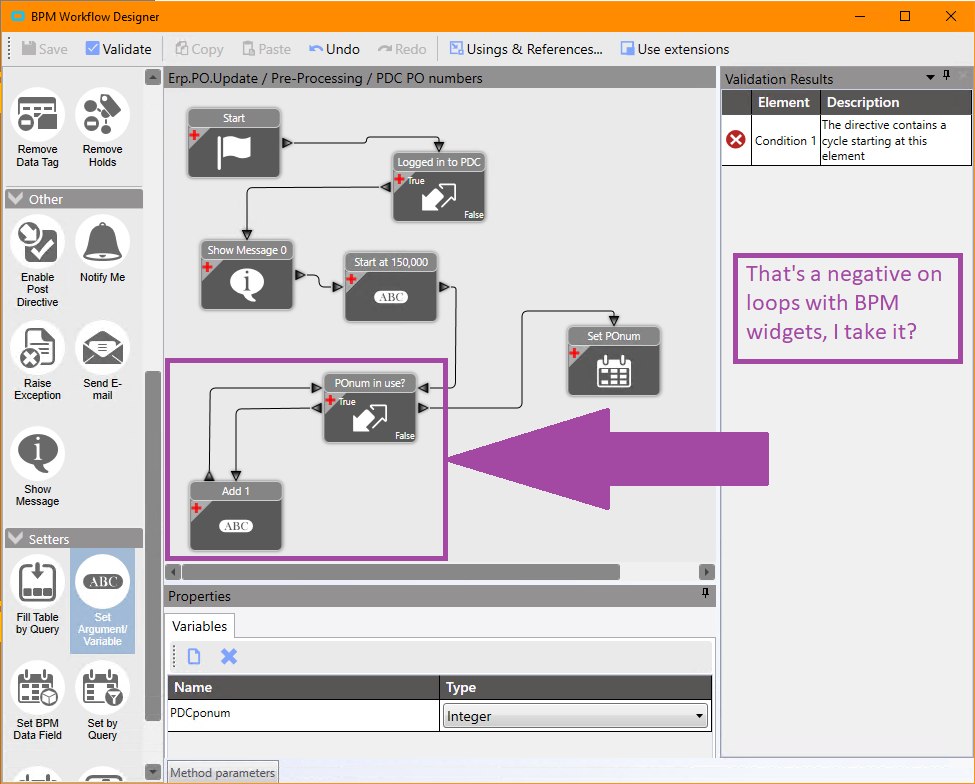

Cannot create a loop with BPM widgets
So, I can’t do this, eh? That’s how I read the error.
I’m sure many of you are laughing at the idea of this code. I just want the next available PO number that is above number X but below the number in company configuration, so that this site can have its own PO number set.
Anyhow, I guess the only way to melt down the system is in C#? Yay.

You can create loops but usually you need to have more than 1 widget in between (unless they changed that recently)

For what it’s worth, I made no changes to my BPM and it worked exactly as I wanted it to. The error in the designer is not a binding law, I guess.
That validation is kind of crap… It doesn’t catch things that it should and, like you’ve found, raises problems that aren’t problems.
