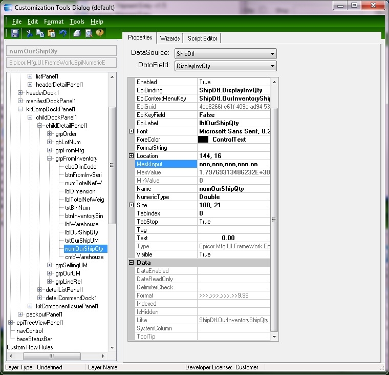

Might I suggest that the proposed solution of conversion 9527 “Set Credit Limit Total” may not address your topic. In the past I have encountered this error and message. For example , this normally occurs when the DB Column Data Type and the User Interface Field Precision are skewed, in other words the UI column’s numeric data type is defined as double precision, the DB field is defined as integer or single precision, and the mask input is defined as “nnn,nnn,nnn,nnn.nn”.
[cid:6f922cfc-4c02-4233-993e-f44b9bbd5e63]
I have corrected this topic using the customization tools to adjust the edit mask to “nn,nnn.nn” and using Customization’s Custom XML Editor added the necessary supporting XML code. The modified edit mask value was selected based upon the maximum single precision integer signed value of 65535.
