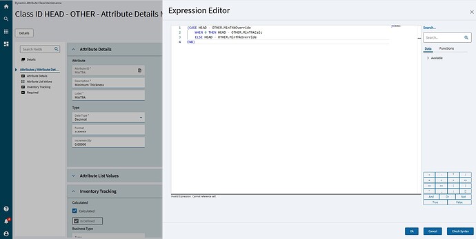

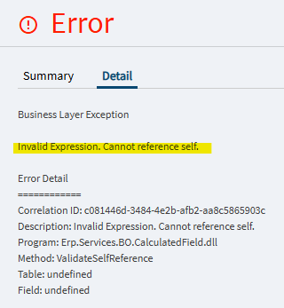

Cannot Reference Self - Dynamic Attribute Calculated Expression
This seems pretty standard SQL. We have other expression that are way more complex.
Cannot figure out what this error means. Any ideas?

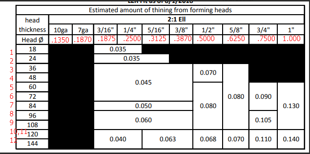

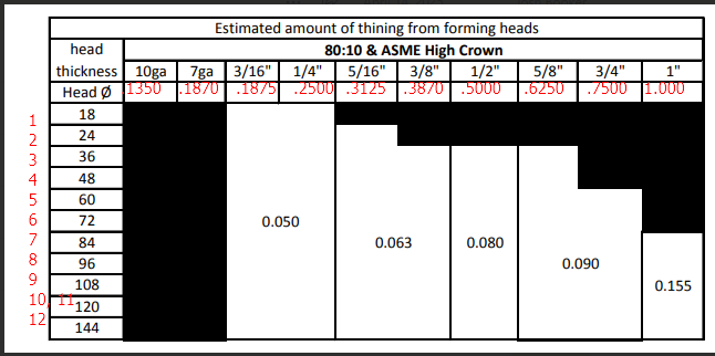

FYI - This is a calculated attribute of a Dynamic Attribute Class. It calulates the Minimum Thickness of a dished vessel head (round end of a tank) using a matrix of thinning factors by diameter/thickness.
Much like any BAQ calculated field except the Dynamic Attribute Class name is used in expressions as if a table name.
Turns out their self-reference checker is poorly done.

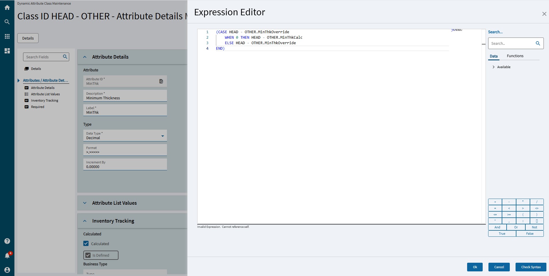

For setting attribute named HEAD - OTHER.MinThk
this works fine:
CASE HEAD - OTHER.OverrideMinThk
    WHEN 0 THEN HEAD - OTHER.CalcMinThk
    ELSE HEAD - OTHER.OverrideMinThk
END

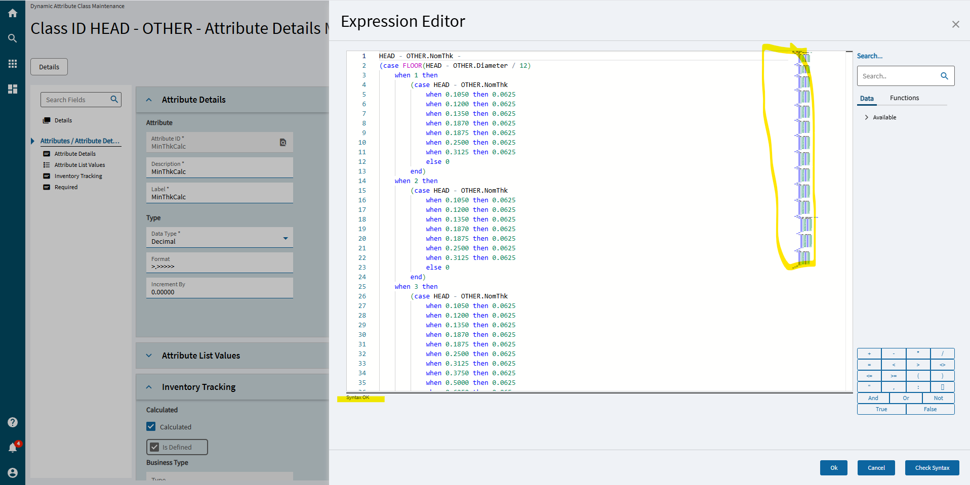

while this doesn’t (notice HEAD - OTHER.MinThk exists in HEAD - OTHER.MinThkCalc)
CASE HEAD - OTHER.MinThkOverride
    WHEN 0 THEN HEAD - OTHER.MinThkCalc
    ELSE HEAD - OTHER.MinThkOverride
END
presumably because they do a simple check to see if the string HEAD - OTHER.MinThk exists in the expression. Rather than also ensure it’s followed by a space or another character to avoid false positive matches.
Pretty sure BAQ calculated expressions don’t do this poorly. or if they do I suppose the forced ‘Calculated_’ prefix avoids false positives in BAQs.

Good question, maintainabilty is all. The matrix is used across several classes and can differ across Suppliers. Decision makers were undecided, so I made the expression atomic for those reasons. They can easily change a thinning factor without considering SQL logic.
Plus, some are not as straight-forward as others.
