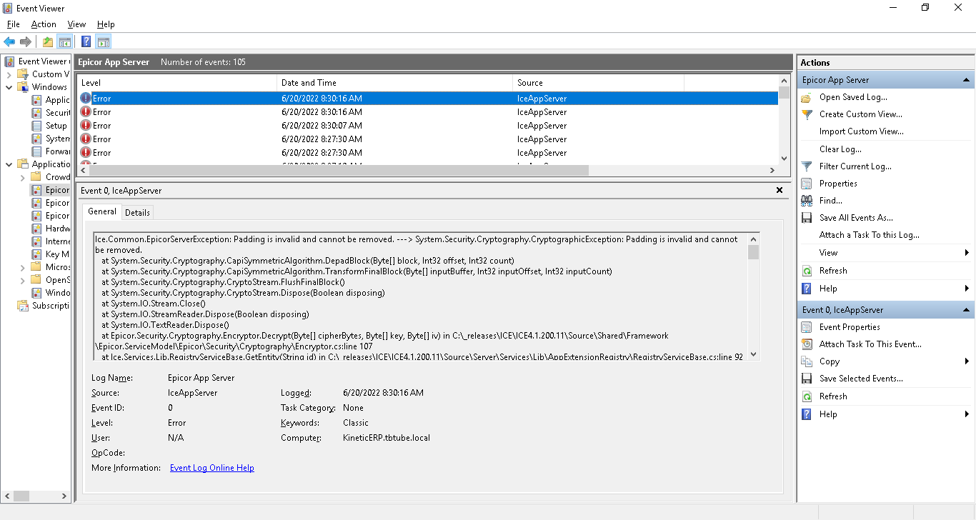

Started getting having issues this morning not being able to save in Kinetic forms. See this on the server. I put a ticket in to Epicor. Not sure what could be causing this.
The issue appears linked to a conflicting file created in the WebDeployment directory.
Create a unique sub-directory in the EpicorData directory.
Update the System Agent to use this new directory. Chances are you are conflicting with another Environment and sharing EpicorData folders?
– Epicor Support

That worked. I did install 2022 in a test environment 2 weeks ago. Odd that it would just surface this morning.
