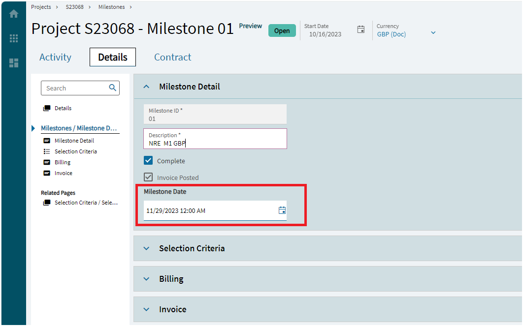

Hi have created a customisation as below and everything previews ok. I have selected the customisation from menu maintenance and copied to company but cannot see the change

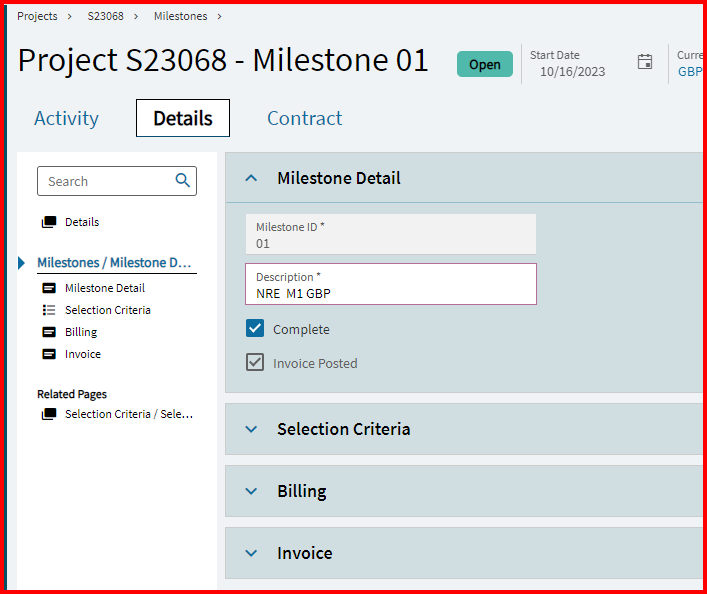

Cannot see in live

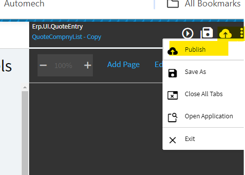

Have you published the layer?
One thing I’ve noticed in 2023 is that publishing from within the app in App Studio does NOT actually publish the layer. You need to exit the detail view, and in the App Studio grid view, select the layers you want to publish and from the vertical … menu, select Publish Selected Layers.
You can confirm this by filtering the landing page to your app and looking in the Draft column. Even when you publish from within the app in App Studio, it will not actually publish and a checkmark will remain.

I had published the layer but then went back in and published at grid view as well.
Still the same I can select the customisation from Menu Mainteance but cannot see the field.
