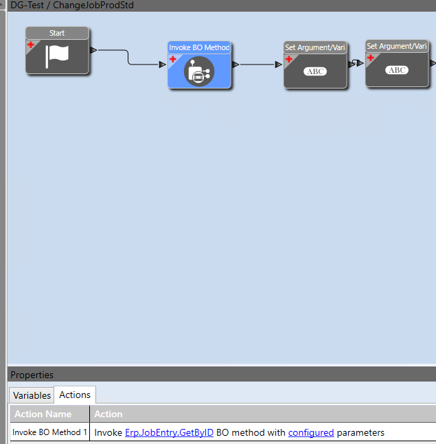

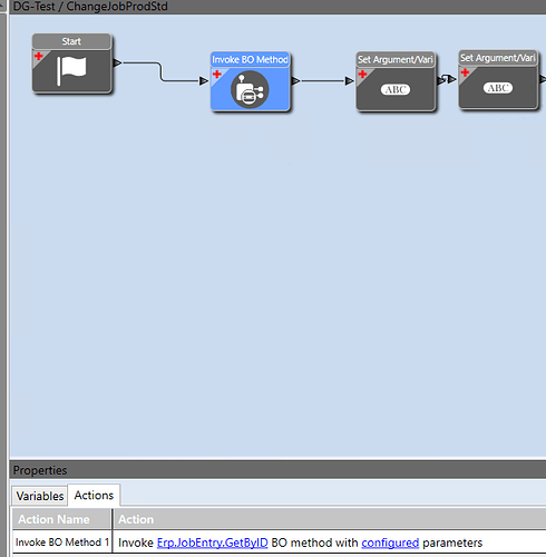

Cannot update ProdStandard from Function Designer, JobEntry.Update

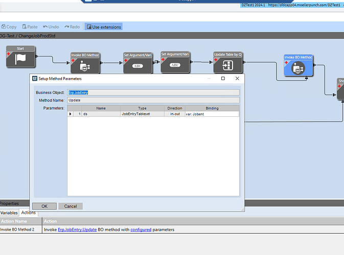

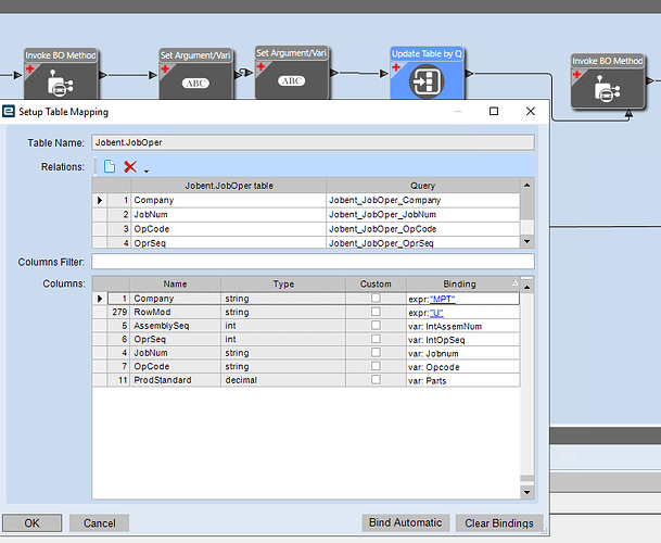

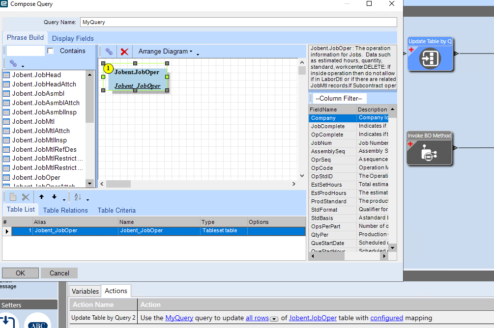

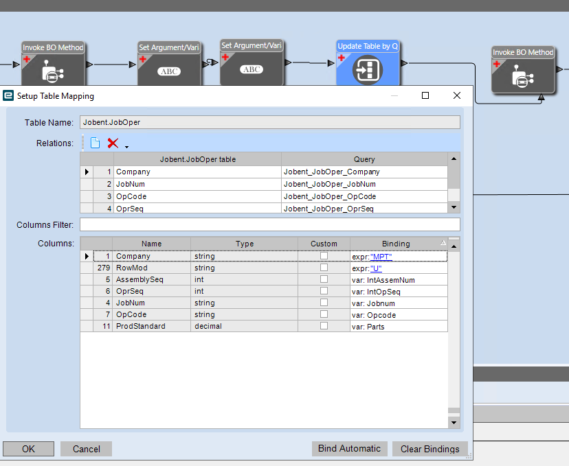

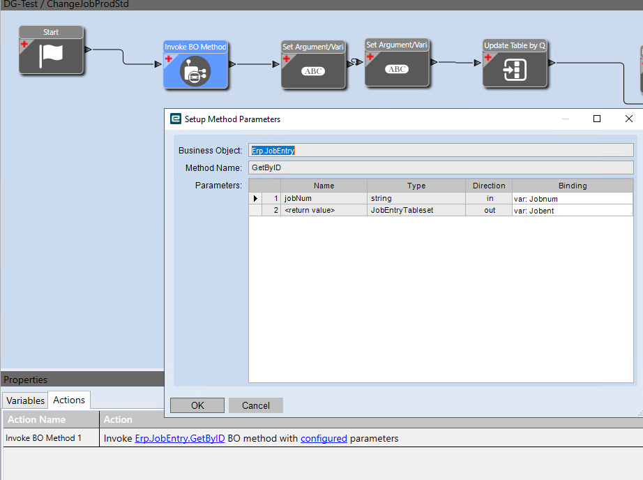

Hello all, I’m struggling to figure this out. I’m trying to update ProdStandard in JobOper based on a customization done in application studio. I’m having application studio call a function. Everything is being called, but when it calls the update BO method for JobEntry, I get “Cannot manually update the Production Burden Rate in JobOper.”
I saw something similar in Function Help - Update JobOper ProdStandard but as I am using a function, I don’t see the option for custom code to follow his instructions.
Is the job Engineered? You can’t change operation details if so. Your function would have to Un-Engineer the job, make the change, then re-engineer the job. A function acts like the manual process, so try changing the standard on that job manually and see if you get the same error.
The job is engineered, but I can go into the job and adjust prod std with it engineered just fine.
Yeah, me too. Hmm. Normally, that would have a scheduling effect. Maybe @JasonMcD can shed some light here. You may want to explain the business problem you’re trying to solve to help us out here.
