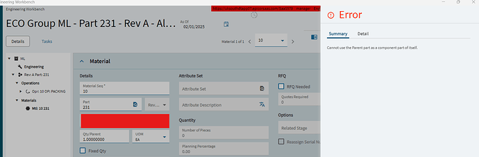

Hi Guys,
We have manufactured parts where sometimes we need to repack and need to issue the material to the job on the same code as the finished product or we may use some spares from a previous job and assign them to the job to consume them and the cost.
In the past we have been able to do this but now when ever i try to assign a material to the job that matches the finished part i am getting the below error.
Has anyone come across this / know how to resolve?

We do agree. He was in Eng WB from the screenshot my assumption he is trying to apply same to a MoM which should not be allowed for the reason I stated in my first post.

Ah - thats what it is, we have been able to do it on the job in the past but not when changing the method.
That makes sense now.
