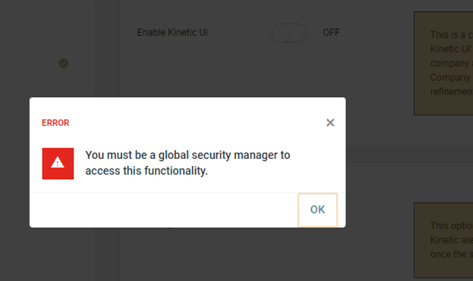

When I pull up Kinetic Application Maintenance, I only get these items in the picture below. I also get our company but I cut that out. And that only allows me to block all kinetic usage for the company. Which is not what I want.
I only need to disable Kinetic for the print label window and I cannot seem to disable it.
I have all the security options authorized to my account. Unless I’m missing something.

Problem is, I try to disable kinetic per the user and it won’t let me. I go to options in the print label window and it shows the drop down for UI options, but it’s greyed out and selected to “Users choice” (forget the exact wording.)
So I tried to disabled it from Kinetic Application Maintenance but that doesn’t work as you can see. And I tried menu maintenance as well. All no go.
