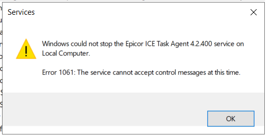

I tried to stop the task agent service and had the below error
I had to manually stop it in Task Manager

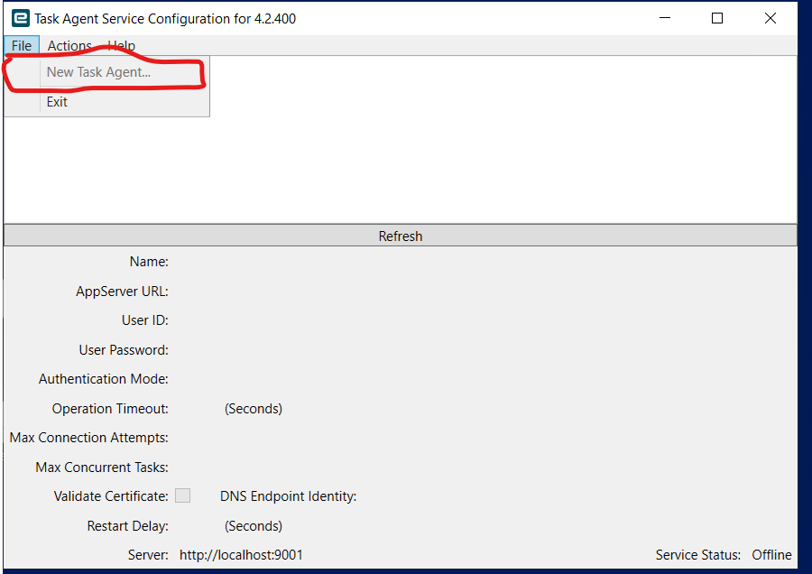

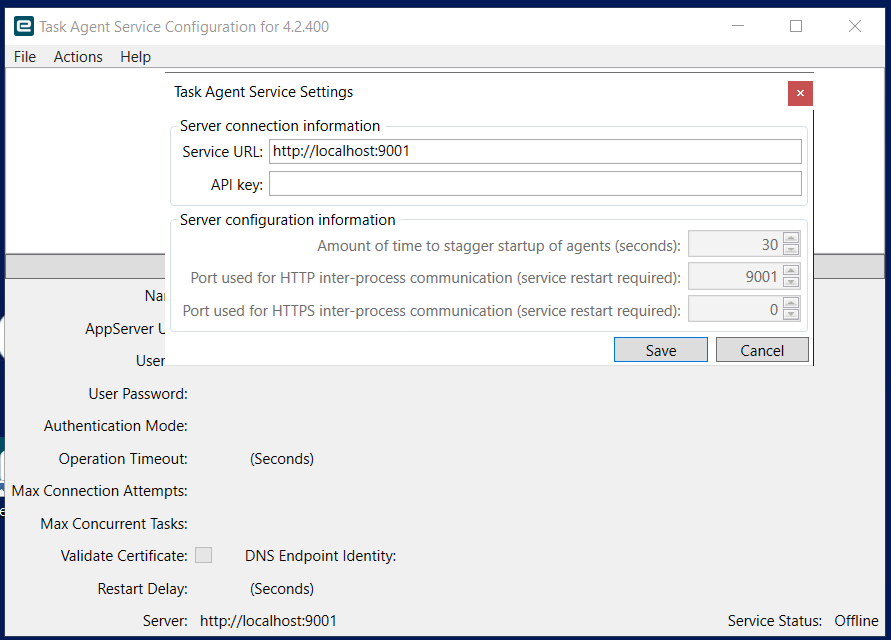

When restart the service and open Task Agent Configuration I get the error below and the Configuration tool open but the new task option is not available
I have Uninstalled the Task Agent Configuration tool and reinstalled it but I get the same error.

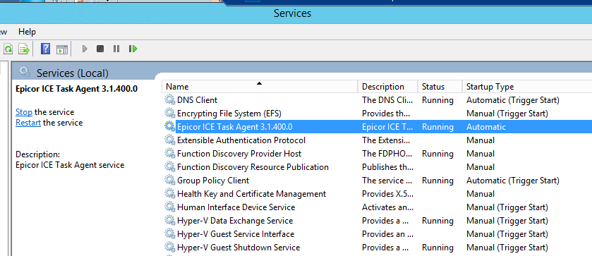

On your server, press Win + R and type services.msc and hit ok.
When the Services window opens, find the Epicor Ice Task Agent service. If its in any status but “Stopped”, right click and stop the service. Then right click and Start the service.
Hi @kve I did that already. It started but the application has the same error. And when i try to restart or stop the service i still get the same error.
