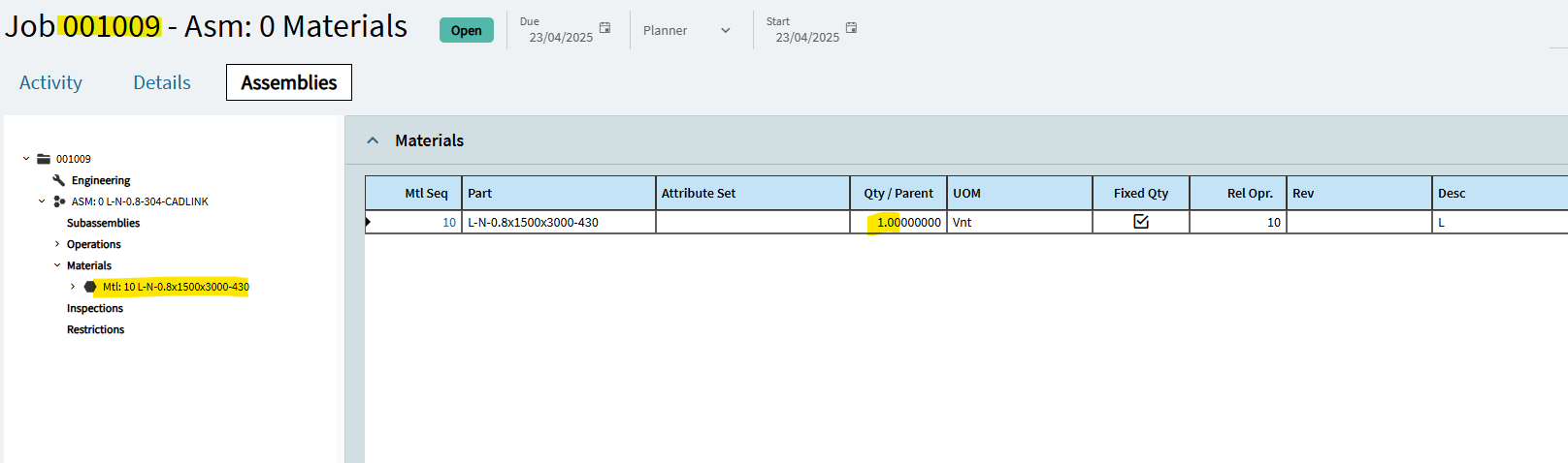

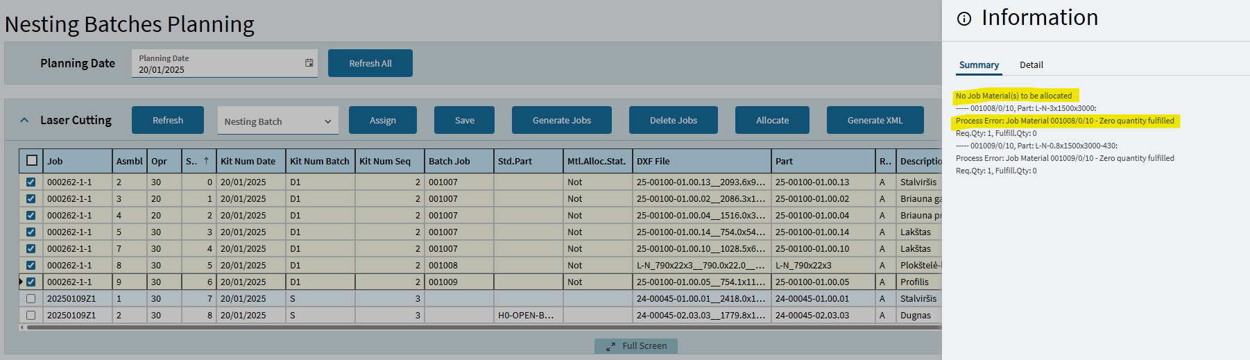

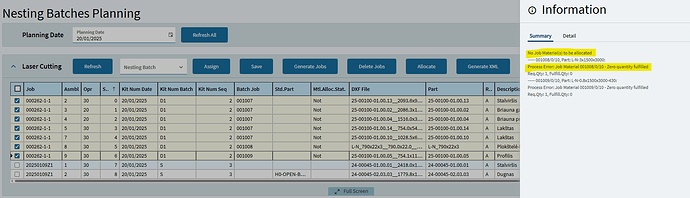

Trying to allocate few jobs, but get error - No Job Materials to be allocated, zero quantity fulfilled.

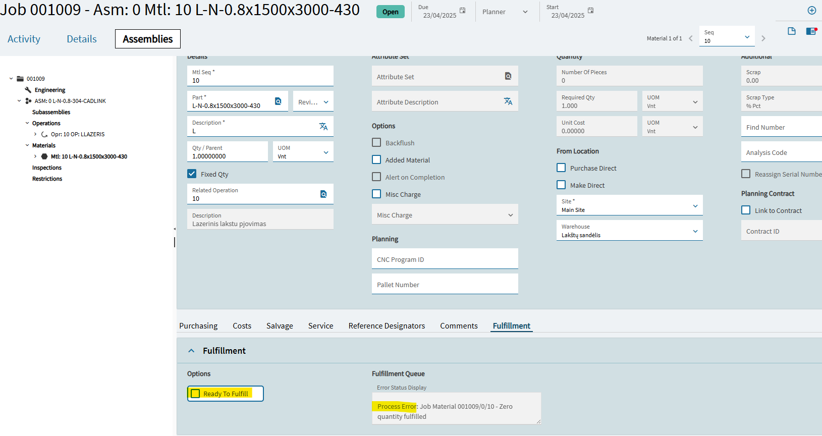

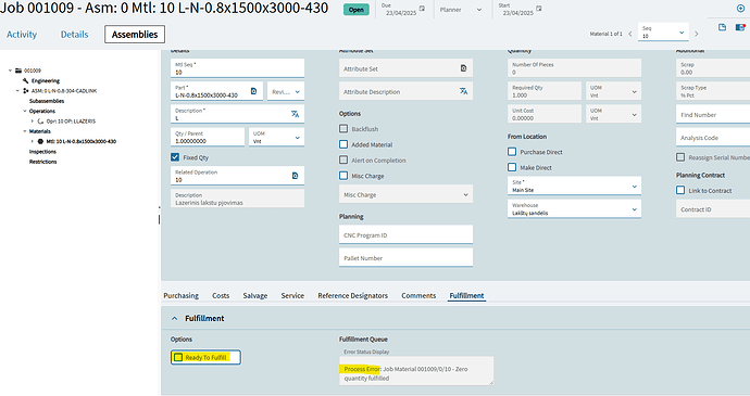

Then I go to this job-assemblies-material and see that Qty is 1, kinda ok.

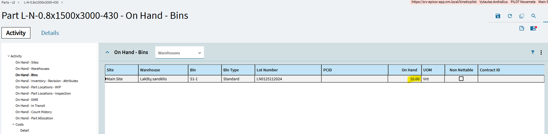

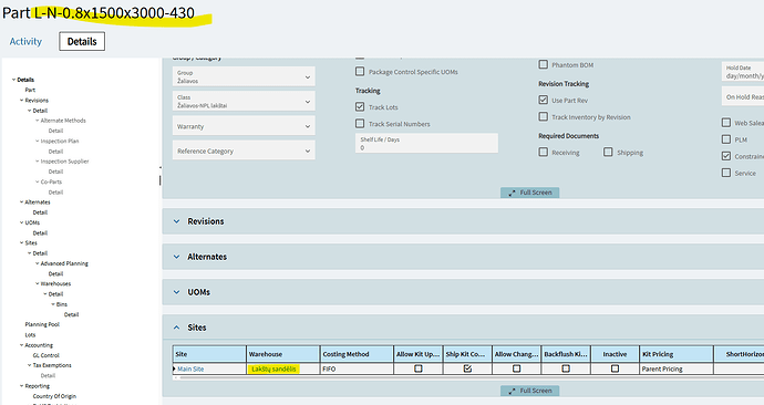

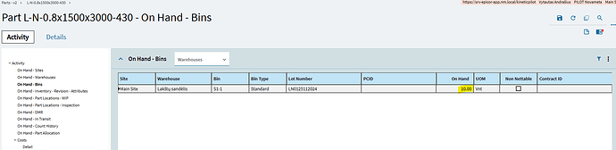

Then Go to that part and check if i have it on hand, there is 10 there:
Bin S1-1
I cant get my head around, what could be an issue, in Job-Material_Assemblies-Fullfilment i see another error, and Ready To Fulfill, I tried to check it , but not change

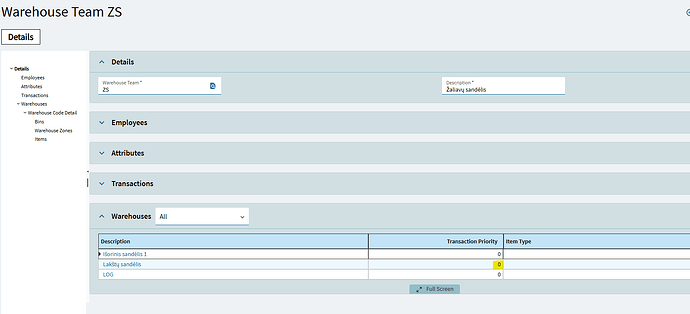

Reached out for support, they said its due to warehouse priorities. Checked Warehouse Team (dont know if its correct place, Im myself from production not from inventory team), there is something called “Lakstu sandelis” (eng. sheet warehouse), and other two. All three marked as 0 Priority, tried to mix it like first 1, second 0 and third 2, but same error while allocating.

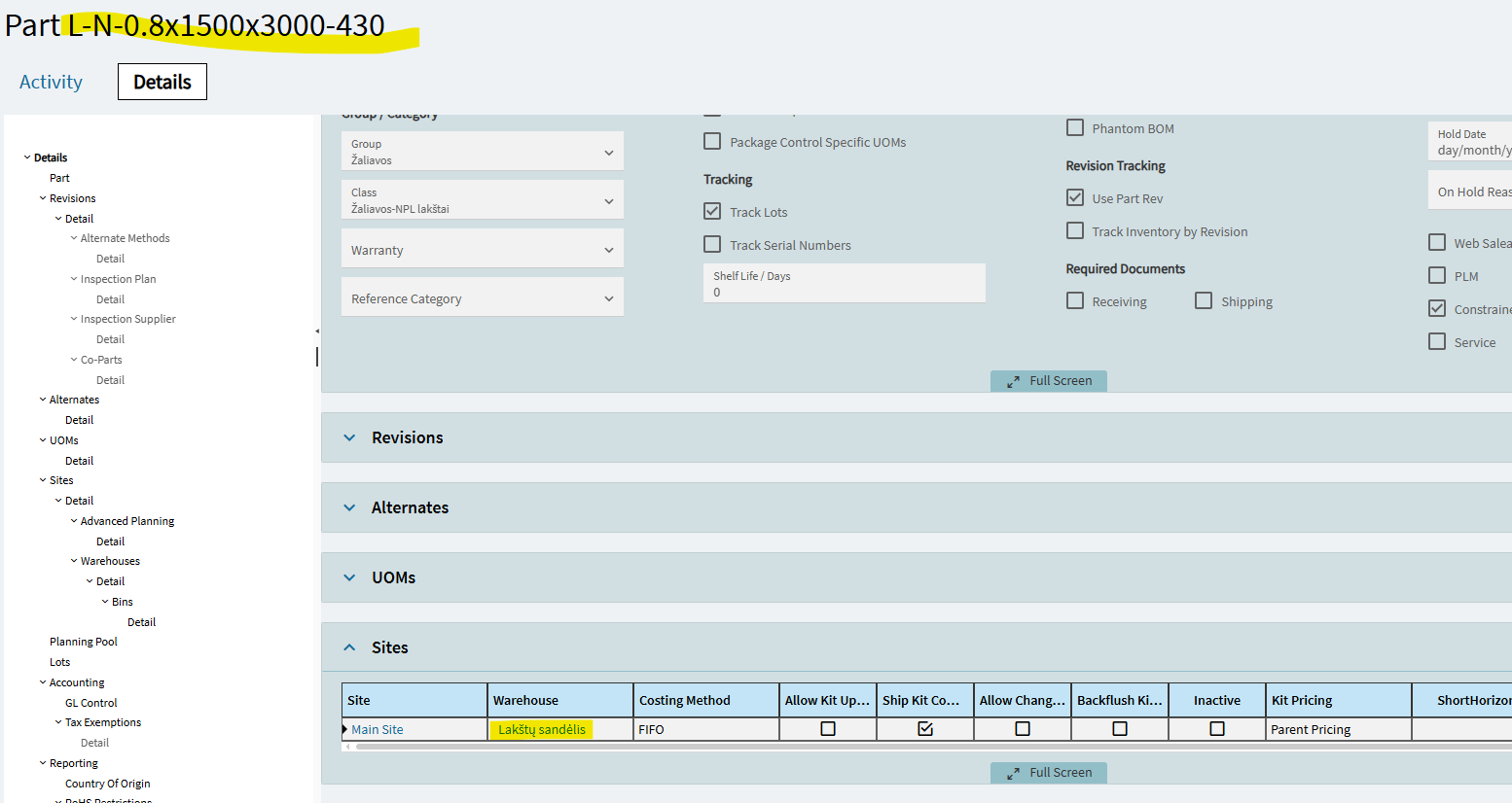

Checked that Part, looks like it sits in correct place
