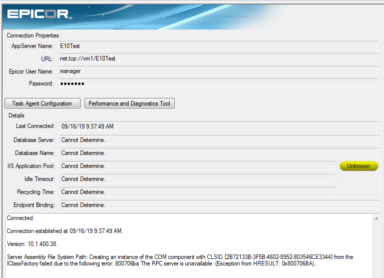

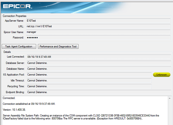

When I try to connect to a server in EAC, the “Create New Session” window pops up that says it’s connecting to net.tcp:// etc. If I click through three or four “snap-in not responding” messages, I eventually get this error:
Creating an instance of the COM component with CLSID {2B72133B-3F5B-4602-8952-803546CE3344} from the IClassFactory failed due to the following error: 800706ba The RPC server is unavailable. (Exception from HRESULT: 0x800706BA)..
Then click through a couple more “not responding” messages, and I get here. I can access the appserver settings and configuration, and I can view users and sessions. But I can’t launch the task agent config (nothing happens), nor can I stop/start the pool (repeat of the error above).

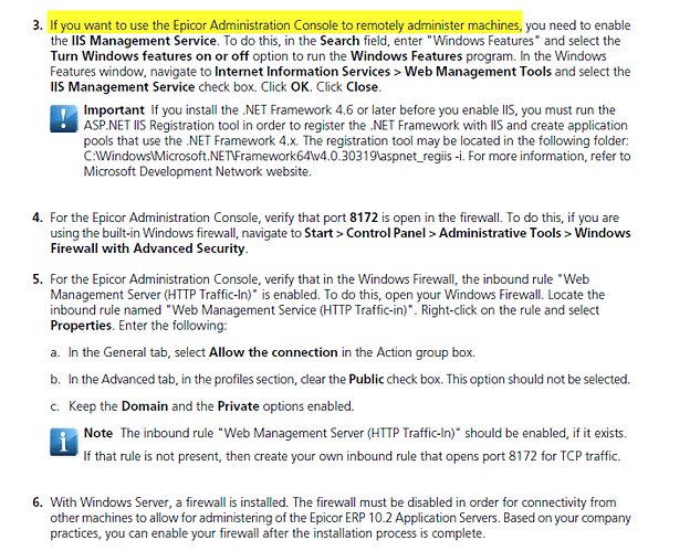

Check out the New Installation Guide, section 2.3 Verify Windows Operating System Requirments, step3 3 through 6
maybe one of those ports or firewalls are no longer open.
Weird…that management service was not turned on for the Epicor server. It’s on now and I’ve enabled the Web Management Service rule, but it’s still hanging.
Interesting that after the explanation of what ports to open in the firewall, it states that the firewall must be disabled for remote administration. That sounds contradictory. Is remote administration frowned upon now?
