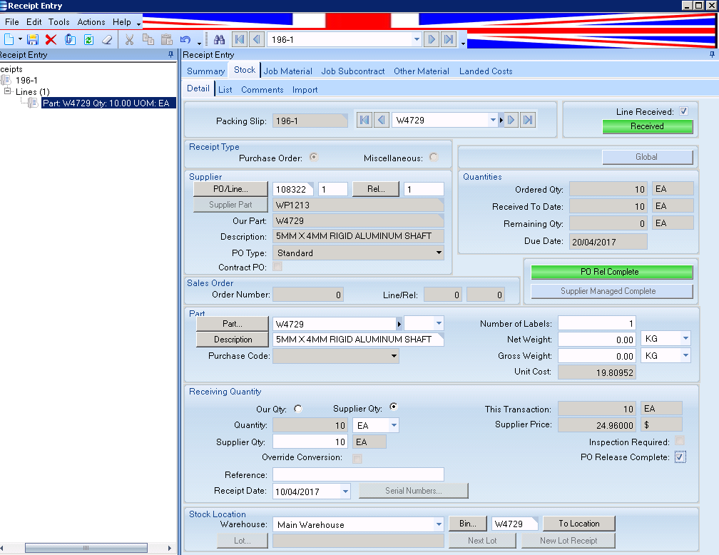

Epicor version: 9.05.701
I’m trying to delete this line off Receipt Entry, but when i do i get a blank error message as per the second screenshot.
Any help would be much appreciated.

anything in the application log files?
sussed it…its because the invoice has been posted.
Which is fine, you can’t expect to be able to edit/delete transactions once the invoice has been posted.
Think of the opposite side of the coin with a sales related issue:
Once step 3) above has been done you cant expect the system to then let you edit 1) or 2)
that’s fair…step off the cliff transactions…
