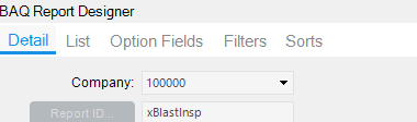

I’m not on-prem, we’re cloud. I’m not sure how much of the process is different but to schedule the report, You’d/I’d use the System Agent which is a completely different module. That’s done after report creation of course.
As for parameters, there options to set those up within the BAQ Report Designer menu:
I’m not a pro on setting those up but there’s plenty of information on this forum regarding that.
I guess there is something specific about setting parameters up but I’ve never had to do this. I’ve only used options and filtering by internal records rather than input. I left the above still so you also know that mostly everything can be setup in BAQ Report Designer.
