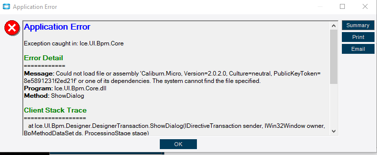

Now I’m trying to edit the design of the BPM and I’m getting this error:
So is my BPM gone forever? Will I really have to re-create the BPM just because it gave an error when firing? Also is there a way to edit the format for these UD fields so I can have more than 50 characters on Key3?
The solution was to just re-install Epicor on my PC. For some reason there were tons of missing files in my Client folder…
