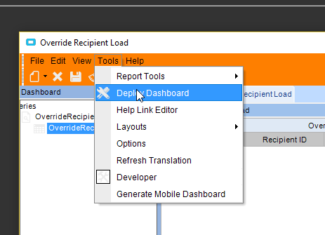

In the Dashboard go to Action -> Publish like you did the first time
He means tools>deploy dashboard.
I did it multiple times (Deploy)

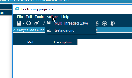

Are you clicking in the grid before clicking on actions? The grid has to be activated/focused (whatever you want to call it.)

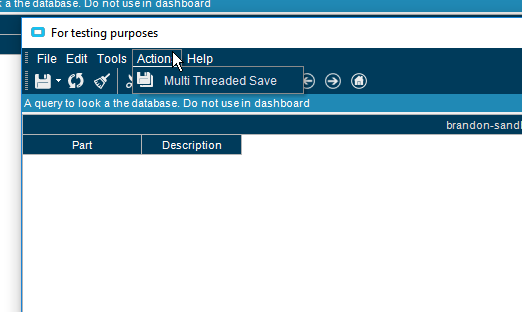

When I click on actions right away
After I click on the grid, and then click actions.
euh… you’re right. Beginner’s mistake. I apologize.
