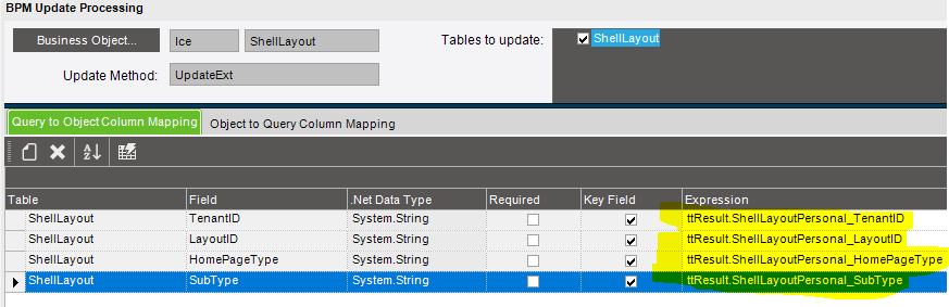

So I was able to make a UBAQ to update this, just had to make a couple changes to what it was looking for for key fields. After doing that and changing the shellhomepage on the users that weren’t working to match the one that was, they now can log in. One of them still gave me an error about Data at the Root level but once I purged that users personalizations, it can log in as well.
One odd bit, in the query for the table, some of the changed fields still show as the old value. But they now work. Others that I changed show the new value and also work.
I don’t have the ShellLayoutPersonal table in 10 so I’m guessing this is created when you upgrade to Kinetic, but it apparently only fixed the one user and left the others with blanks or the tempuri.org address.
Currently waiting for support to tell me if they want me to go ahead and fix them all with the UBAQ or if they want to send a fix.
Just in case anyone needs the changes for that UBAQ to get it to work:
