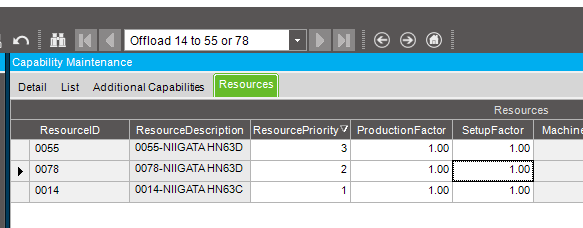

What I generally do is specify the alternates as the first possible choice (oddly enough, that means it will have the “highest priority number”). Then, I list the original resource as the “lowest priority number”. I’ve snipped one below for illustration.
In an infinite environment, I have no idea how the system selects the resource from the capability. (we run full finite here). I suspect it will take the “highest priority number” resource, as that seems to be normal operation of the scheduling engine.
Machine 14 is in a different resource group than machines 55 and 78. The way this will work is the system will look for time on machine 55 first, machine 78 second, and lastly Machine 14.

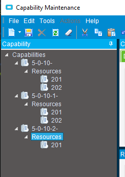

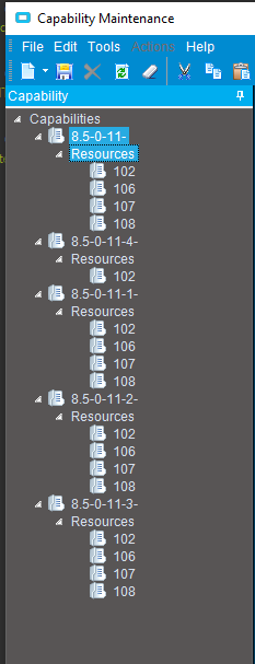

We use capabilities to manage our print abilities. Example take a Paper Bag size 8 1/2 x 11. We can produce that on machines 102, 106, 107, 108 without print. So we created a capability for plain bags with all those machines on it. Then a capability for 1 color, then 2 color, then 3 color and so on. We have one machine that can run 4 colors all the rest can only run 3 max
I customized the crap out of capability maintenance to make managing this easier

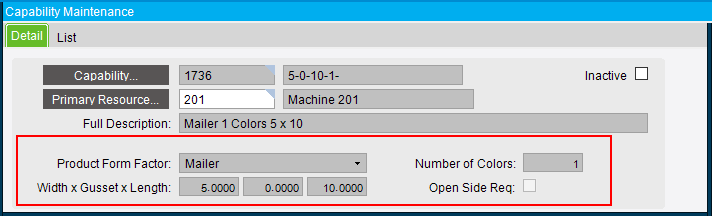

Same with this mailer product
Based on these custom fields I generate the capability ID
