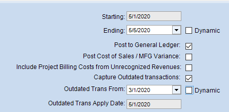

Not sure I fully understand but would the capture outdated transaction box work for you? If checked it will get the old unposted transactions from whatever date you enter in the Outdated Trans From box and post them with an apply date equal to the Outdated Trans Apply Date box.

Trans actions can only be applied to open fiscal periods. So the Capture process would apply transactions with apply dates in open periods, using the apply date. If the Captures Outdated trans option is selected, unposted trans in closed periods will be posted, but to the earliest of the oldest open period.
For example:
- there’s an unposted PO receipt dated 3/30/2020
- period 4 (April) is still open
- today’s date is 5/5 and Capture COS/WIP is run with
- Ending 5/5/2020
- Capture Outdated is selected
- outdated Trans From: 3/1/2020
Would apply that PO receipt to a “Periodic Posting Process” with a date of 4/1.
You can tell what the oldest open period date is from the Read Only field labeled “Outdated Trans Apply Date”
