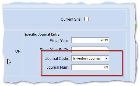

Best way to verify this is to run it w/o the option, then run it again with the option. Then find the “Periodic Posting Trans” in the GL, and note the GL Code and number. You should find two with todays date - most likely not in the same GL acct. Note them both.
Next, run the WIP Recon using the GL Code and Number for each from above.
The two outputs of the WIP Recon report will show the posting for the trans that didn’t hit COS, and the the postings for the trans that do.
