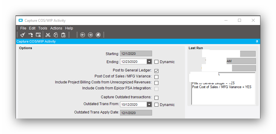

If the user forgot to change the date on the capture screen, it would have defaulted to posting the current period’s transactions, so the transactions should have been December transactions that got posted to December, while there are still November transactions that are unposted because of the mistake.
Yeah, I forgot that in E10, the Starting Date is automatically determined by the Ending Date. Based on the settings in the screen shot above, unposted November transactions (actually, any transaction prior to 12/1/2020) would remain unposted.

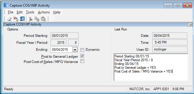

But the V8 settings slightly different.
I forget what happens to old/outdated trans in V8
It looks to me like it should still just do the current period, but I never worked with V8 so you’re probably right. Without seeing the GL transactions/ Inv/WIP report after the capture I can’t say for certain that the V8 capture wouldn’t have done something weird with November’s transactions.
I thought it (V8) would warn you when unposted outdated trans exist, and force yo to fix them. That might have been V4 (Yes we ran Vista 4, with its FoxPro DB)

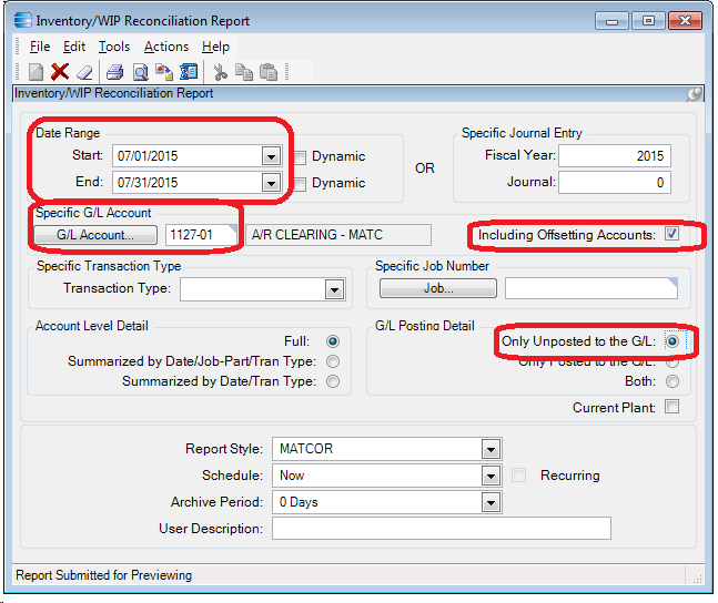

Run the Inventory WIP Recon report. Play with the “Posted”, “Unposted”, and “Both” setting, as well as the dates. I believe you can also specify the FP and FY to limit the range of transactions (but only shows posted ones)
The JE’s is really the way to go. You should be able to get the JE’ necessary from the Summary at the end of the report.
I don’t recall if V8 has it, but in E10, you can specify a GL Code and line to find out the transactions that made up the “Periodic Posting Process” entries in the GL.
Found an old image of the Inv/WIP Recon report form from V8
To see the details of a “PPP” entry, enter the Year and JrnlNum in the upper right fields. I believe most other fields will become disabled.

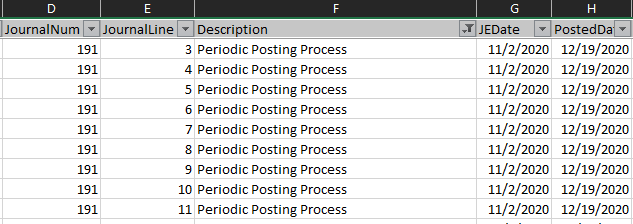

I have a BAQ going against the GLJrnDtl table. I see the transactions with “Periodic Posting Process” and have JE Dates in Nov and Posted Date of Dec. are these the one’s?
Yes. If you enter the FY and the JournalNum in the Inv/WIP Recon report (2020 and 191 in your example), it will give you the details of what makes up that GL Entry. It won’t be limited to a specific GL acct, it will show all the Part Transactions that were summarized together to make the Journal Number.
