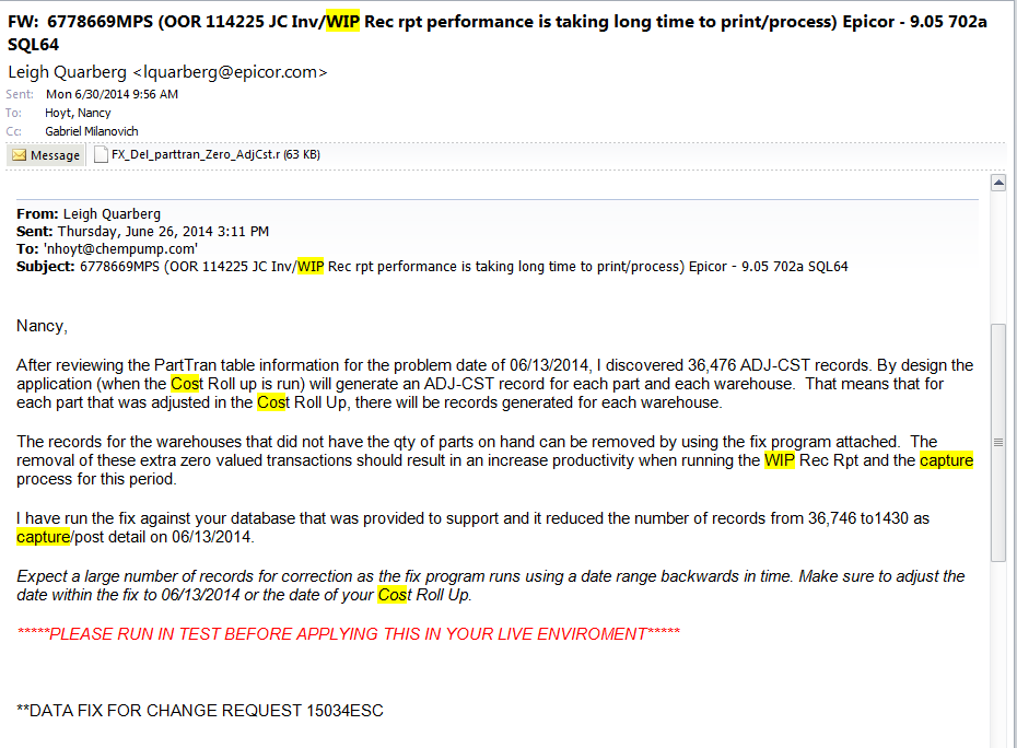

Did you do any recent cost roll activity? We had problems with needing to delete a bunch of adj-cst records with zero value transactions per screenshot of support below to get it to run awhile back…

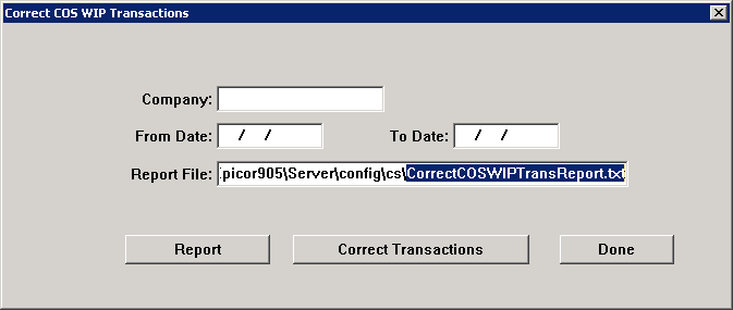

Here is what the screens look like when you run them:
NEW_CorrectCOSWIPPosted_xxx.r
NEW_UnpostCOSWIPTrans-NoStk-Stk_xxx.r
I’m not exactly sure what the Correct Trans one does but I bet I can guess what the Unpost one does! :wink: LOL
