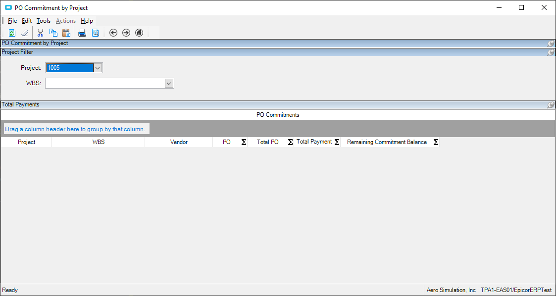

I have created a dashboard that has project ID as part of its criteria. If I just use that out of the box as a filter I see the project description instead of seeing the project ID which is desired. Instead of using the default project combo, I created a BAQ combo that points to a BAQ that only returns the project ID. That works fine. I then want to have a second combo that returns project phase data based on the selected project ID. I created another BAQ combo to fill it in, but I can’t seem to get the filter right. I have read where people use EpiBinding:BO.field to get the filter based on another field on a form. However, I am working with a dashboard that doesn’t have EpiBinding data. Someone made a comment you could do something like YourForm:field.Text but I don’t really know what the name of the dashboard would be to fill that in properly. What do I need to do to get the second BAQCombo to filter off of the selection in the first?

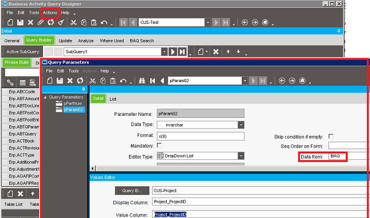

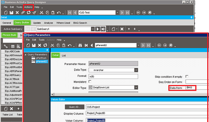

I wonder if you can do them with parameters in the BAQ instead of setting up your filtering at the dashboard?
Where I might use trackers in a dashboard for simpler filters as they are fast/easy.
When I get to more complicated filtering, I start looking at BAQ parameters instead, which (usually) offer more/better control.
I am trying to get the second combo to be based on the first. When I choose a project, I want the WBS Phase IDs for the project to be filled into the combo. I also have the first combo tied to a query since I want the project ID not the description. The first combo as a BAQ combo works fine, but I don’t know how to tie the second BAQ Combo to the user selection in the first.

My dashboard has a blank tracker view, and a grid showing the rows from a UD table.
Then I customized it. I added in the combo boxes, and text boxes, and gave them some names. At this point it is notable that I did not choose a BAQ datasource for these combo boxes from the properties menu. I am using EpiUltraCombos. I left the EpiBinding blank.
Now in the customization code we have to make events to tell when we leave the first combo. This is tricky because sometimes you can’t use the built-in wizard to insert the event elements into the code for controls that you add to the form. When you do use the wizard, it adds a line to public void InitializeCustomCode() and public void DestroyCustomCode(). Then it puts the actual event code near the bottom.

Notably, you have to change the native control ref ID to your GUID for the combo box you added. Check the properties for the control to find EpiGuid. You will also need to make a BAQ that looks up the values you need. In this case the name of the BAQ is getPartRev. The BAQ has a parameter in it that filters for part number and returns the revisions. The BAQ is dead-simple:
select
	[PartRev].[RevisionNum] as [PartRev_RevisionNum],
	[PartRev].[RevShortDesc] as [PartRev_RevShortDesc]
from Erp.PartRev as PartRev
where (PartRev.PartNum = @part)
Now you can start to see where some of the field names come from in getRevs(). Back in the leave event for part number, I also try to force the combo box to update after I use getRev() to give the combo box a data source. To force the update I use: cmbRevs.ForceRefreshList();
Now if you want to do this for Resource Groups and Resources, you will first need a BAQ that can return the list you expect to see in your combo box when you provide it a parameter. In my example the user types in the part numebr to start, but you will want to select the resource group from a drop down box. Since there are no parameters required for the resource group combo box, that bac be populated with a simple BAQ that does not have a parameter and just returns all the resource groups. You could add filtering in the BAQ so that only a subset of RGs you care about are returned.
Then you add a combo box for your resource group to your dashboard. Instead of an Epi Ultra Combo use a BAQ combo. Set the properties for the combo box: DynamicQueryID: Your BAQ name DisplayMember: the name of the field you want to see, ValueMember: the name of the field you want to store. These can be the same.
That should get your first combo working. Then you want to add a EpiUltraCombo for the Resource drop down. This will be populated by code similar to what I wrote above. You will have to add an event for when the user leaves the Resource Group combo. I like to make sure the user selected a value, otherwise the next BAQ won’t have a parameter value to filter by, and will either fail, or return all the resources.
I hope this helps! Good luck!
