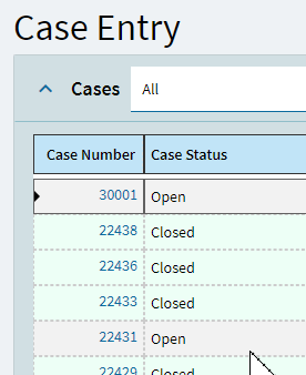

I have done a reasonable amount of customization on my details pane, including a c_AfterRecordSelected event that adjust the titles and hides or shows a button and a panel depending on a UD field being “set” or not.

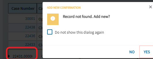

All was working nicely UNTIL I added and removed and reordered some columns on the landing page. The Case Number link now seems to momentarily change display from “1234” to “1234.000” and then says it can’t find the record, add new?

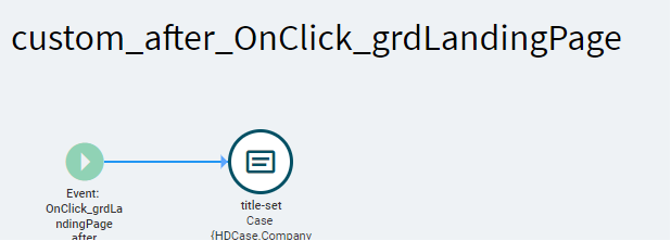

One though I have, I did have a custom_after_OnClick_grdLandingPagec event earlier, which I have deleted as its functionality is now being done in my other event. I think it was still working after this, and before my change of landing page grid columns, but can’t be 100% sure (soooo many clicks)…

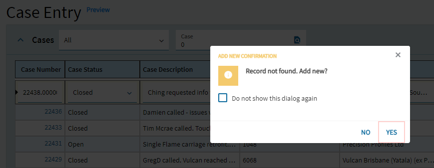

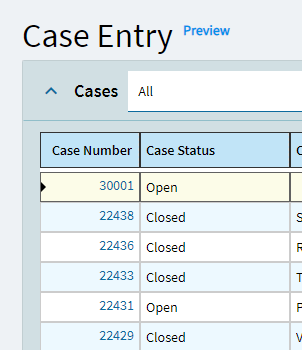

Update: It appears to be after clicking on the view options for the grid. I was able to import a partial solution from another database and start again… then some hours later I had added data rule highlighting for open cases on the landing page:
But I also wanted to add another view in addition to “All Cases”, one for “Open cases”, so started doing so but as soon as I had added a view via View Options, my landing page seemed to lose its “normal” landing page colouring (let alone my highlighting) and now when click the link the Case Number link it again flashes up the case number with funky formatting 1234.0000 and doesn’t find the case:

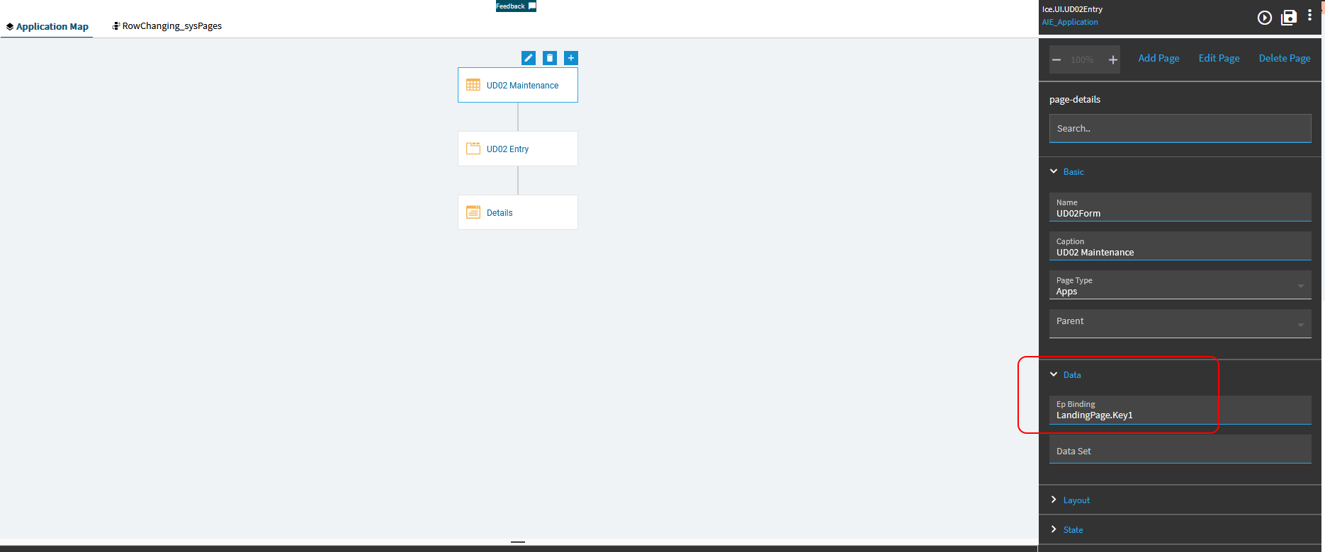

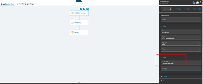

Digging up an old chain, I know, but I was able to locate the source of my problem causing the same error. Randomly as I was modifying a new layer, the grid links would just quit working on me.
I used the debug tool on the base form and my layer preview to find the issue. The sysPages dataview appeared to no longer have the correct epiBinding in my new layer (it was blank) whereas with the base form, it was lined to LandingPage.Key1.
Looking at the properties of my main page, it indeed appeared to have lose it’s EpiBinding. I put the binding back to “LandingPage.Key1” and the links started working again!
I hope this helps someone in the future as it cost me almost a whole day of recreating new layers!
