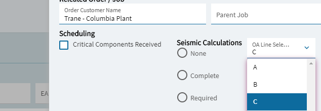

In the Job Entry screen, I’ve created a slide out with a Dropdown list that is generated via user codes. This is working fine; it’s bound to a UD field.
When the user hits save on the job entry screen, I want to update two fields in the JobOpDtl table based on what they selected in the dropdown list. What is the best way to accomplish this?
