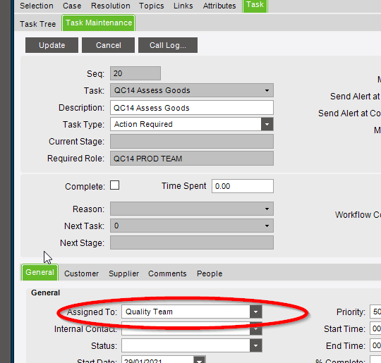

When i add the task to the case, what i find is that the task is assigned to the role that the first milestone is assigned to. Not what the Task setup is assigned to…

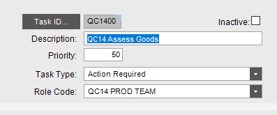

Example: Task set “Assess Goods” which is setup to be assigned to a QC14 Prod Team:

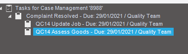

But when you add teh New Task to a case:
I can see the Assigned To is defaulted , it doesnt make sense why it doesnt pull the Tasks Assigned role
Any advice appreciated - i realise I can change the assigned to- but its another step id sooner not have to enforce

Thankyou Ive tried this and still it carried the Quality team unfortunately :frowning:
@carlawhite, have you created the new case?
Yes I did
