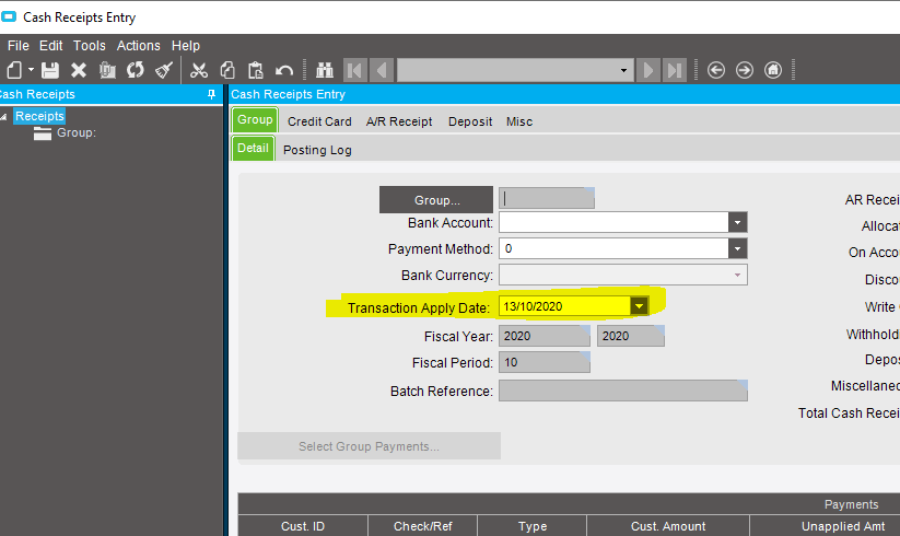

Anyone knows how to do in cash receipt entry, Cash receipt date greater than Invoice date validation.
@Naveen_Kumaar_P
Is my below understanding is correct ?
Invoice
InvoiceNum :0001
Invoice Date:12/10/2020
Cash Receipt
GroupID:- 001
Bank:- ABCD
Transaction Apply Date:- 11/10/2020.
This transaction should not be allowed, because the cash receipt transaction date is lesser than the Invoice date .

we need the transaction date changeable, a current period greater than the invoice period means not allow.
Back dated transaction they will do in cash receipt date. example 09th month,
Cash receipt date 13/10/2020
invoice date should not 01/11/2020

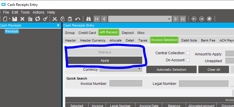

Try finding the method at “Retrieve” or “Apply” through trace.
My be the method is “Erp.CashRec.SelectInvoices”
BPM validation comparing Invoice date and transaction apply date.

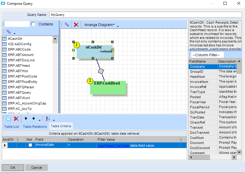

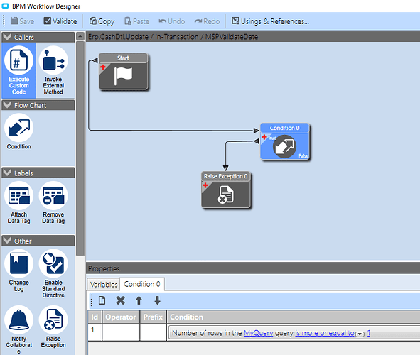

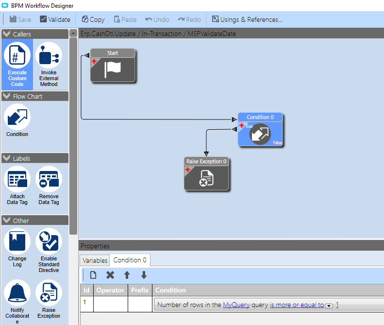

@Naveen_Kumaar_P
In Transaction Data Directive in CashDtl Table, will work.
@prash172 above data is working. Thanks.
need to change the condition.
If the cash receipt date is 21/10/2020 and the invoice date also in the same month 30/10/2020 this no need for validation. greater than that period means invoice date 01/11/2020 needs to validate. is it possible? Any idea.
