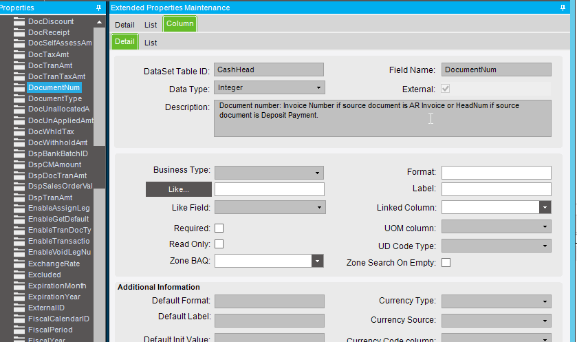

Just wondering if anyone can point to any bit of information that states the default length (in digits) of the DocumentNum field for the CashHead table has been set to a certain length? In the Extended Properties, it has no format, yet in the Apply Credit Memo form, it is limited to 7 characters.
This is not ‘too’ pressing of an issue, as providing a format in the Extended Properties (>>>>>>>9) solves our issue, however, curious to know where this limitation of 7 characters has been defined.
Note, the field in the database is an int (HeadNum), and this also occurs on the base form (no personalizations/customizations loaded).

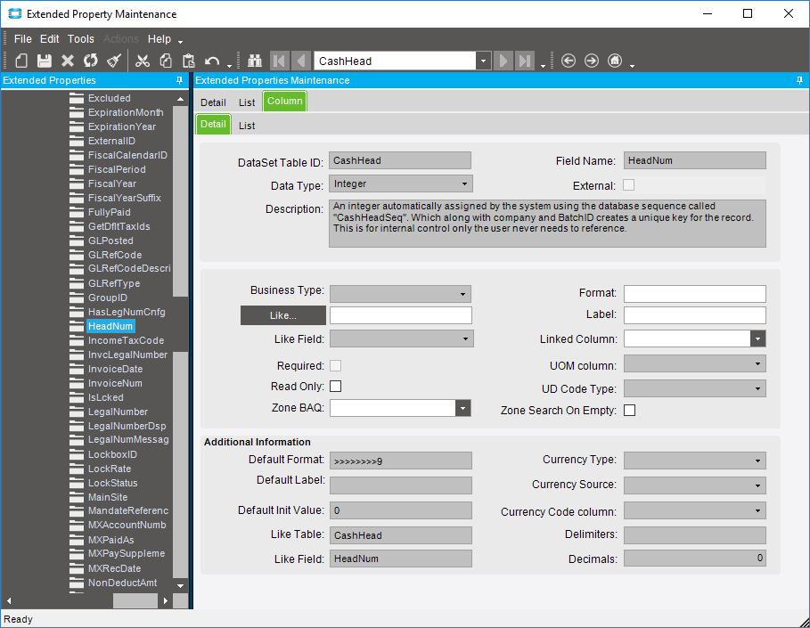

Here’s the default format I see in 10.1.600.9:
Apologies Aaron, I put in the wrong field from the database - but your answer gave me something to think about.
The DocumentNum field in the Extended Properties states that it is either the HeadNum or the InvoiceNum; both of which, as you point out with the HeadNum, are of format >>>>>>>>9. However, the DocumentNum field has no format set - so I would assume it would inherit those formats - right?
The one thing I am seeing that is different is the External boolean is flagged on the DocumentNum… Further investigation may be required :slight_smile:
