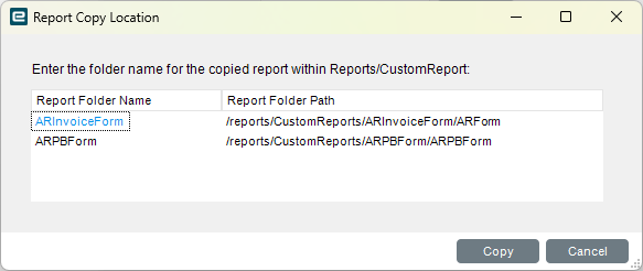

I might have taken a slightly different approach. Copied the broken report style to a new SSRS folder, when you copy the report style you will be prompted with the Report Copy Location dialog:
Before image:
Then change it to something like:
Then you can download v1 and mess with as much as you like, when you know it is working, then download the original, and on your PC or wherever you have downloaded and modified the V1, copy it to the path of the original and upload. This is of course you just download the SSRS Report to the default locations which is typically My Documents/reports.
