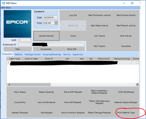

I agree with Brandon…. Hide the current button and create your own. I added a custom button to our MES screen for printing material tags. When they click the button, I take the user to a customized UD table (UD39) entry screen to gather some info from them (and then had a button on that screen to call the Print Material Tags form).
I customized the main MES menu to add the custom button control to the form.
Then the click event did something like:
ProcessCaller.LaunchForm(oTrans, "Ice.UI.UD39Entry");
Then I created a menu item for UD39 and applied my customized UD39 form to it.
Then I added an entry in Process Calling Maintenance that pointed the UD39 entry form to actually call my customized version of it.
Hope that helps. Good luck!
