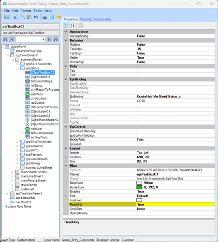

There is one more outstanding issue with this customization. Even though I have the custom {QuoteHed.VerStmntStatus_c} field set as ReadOnly (see screenshot), it is not read only and users are able to edit the field. I assume this is because the UseAppStyling is set to False??
Is there a way to force this to be readonly in code?
Yes, but I would edit the extended properties on the dataview instead and make it readonly there.
If you search for “extended properties readonly”,
you should be able to find some examples.
