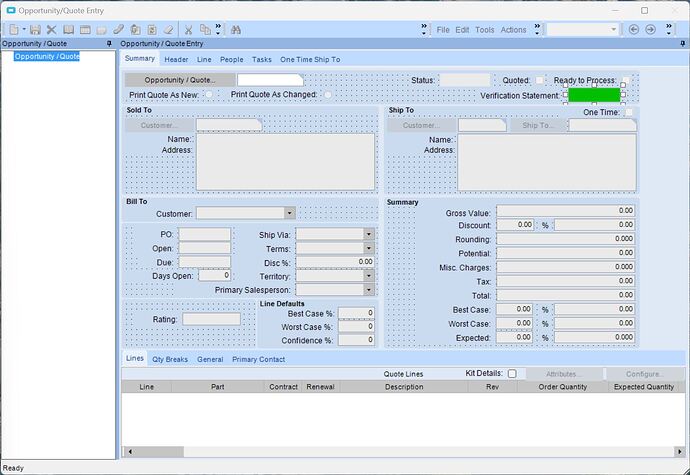

Well, yes actually, I do want the color of the textbox to change after clicking on the new Quote button, entering a customer ID (or searching for it), and hitting tab. At that point, I have a Method Directive (Erp.BO.Quote.GetCustomerInfo / Post-Processing) that populates the {QuoteHed.VerStmntStatus_c} UD field based on two UD fields in the customer record.
Based on the value that gets populated in {QuoteHed.VerStmntStatus_c}, which could be four values, I’d like the {QuoteHed.VerStmntStatus_c} field to be a certain color.

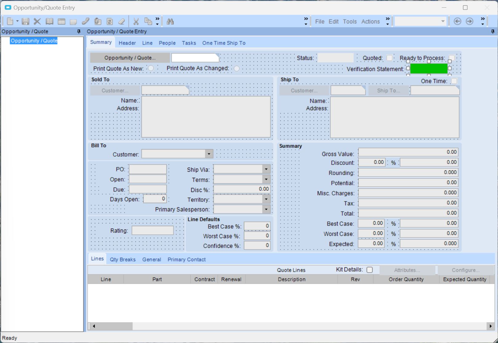

Y’all are overcomplicating it. :slight_smile:
using System.Drawing;
private void SetTextBoxBackColor(EpiTextBox textBox, System.Drawing.Color color)
    textBox.UseAppStyling = false;
    textBox.BackColor = color;
System.Drawing.Color originalTextBoxBackColor;
bool defaultTextBoxBackColorIsSaved = false;
private void epiTextBoxC1_TextChanged(object sender, System.EventArgs args)
    if(defaultTextBoxBackColorIsSaved == false)
        originalTextBoxBackColor = ((EpiTextBox)sender).BackColor;
        defaultTextBoxBackColorIsSaved = true;
    switch (((EpiTextBox)sender).Text.ToLower())
        case "on file":
                SetTextBoxBackColor((EpiTextBox)sender, Color.Green);
            break;
        case "expired":
                SetTextBoxBackColor((EpiTextBox)sender, Color.Red);
            break;
        case "somethingelse":
                SetTextBoxBackColor((EpiTextBox)sender, Color.Orange);
            break;
        default:
                SetTextBoxBackColor((EpiTextBox)sender, originalTextBoxBackColor);
            break;
