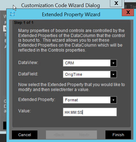

I want to change the Column Format from INT to HH:MM:SS. The field is [OrigTime] which is an integer value.

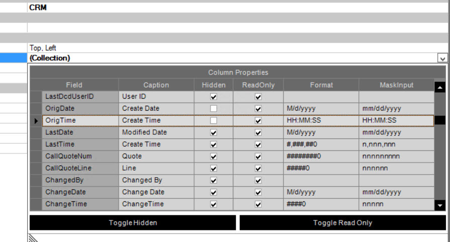

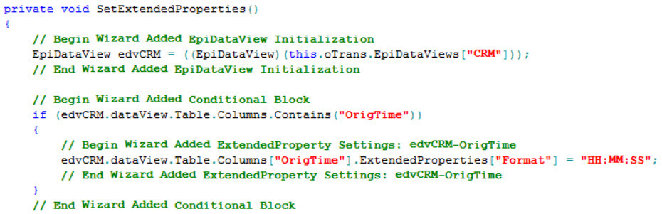

I tried changing the Grid Collection Properties > Format and also the Extended Properties of the DataView column.

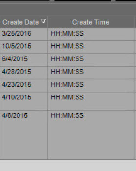

The end result in both cases shows “HH:MM:SS” in the displayed results

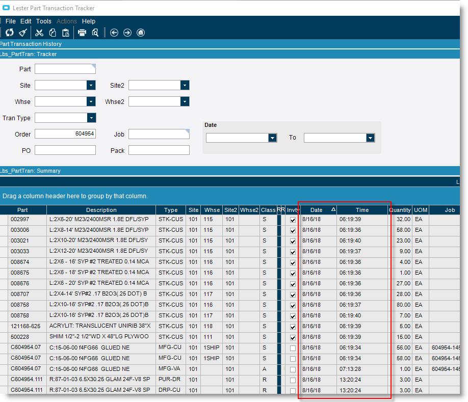

If you want a time then the easiest way is to add the time field value in seconds to the relevant date field and then format the result. We’ve added a datetime UD field to our PartTran table to get round the problem in Part Transaction History Tracker, and a BPM keeps it in sync with Epicor’s fields.
Or, make your own Part Transaction History Dashboard. I’d be willing to share if your interested.

I believe the time is seconds since midnight.
DateTime.Now.Date.AddSeconds(your time in s).ToShortTimeString();
//or sql if you are doing a Calculated Column
