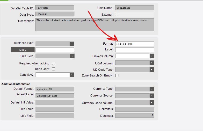

I am working with the PartPlant table in epicor and need to change the format to allow more decimals in a certain column. However, everywhere I’ve looked says to do this with a direct sql update, which I know is not the best way to go about this. Any one out there done this before?

And yes, I avoid direct SQL updates at all costs!

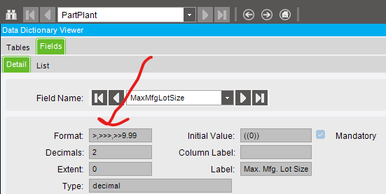

So, from my understanding, editing the format like so will change the format in the database, and the default format is just what it comes set up with?
Yes, you would modify the format here but if I remember correctly, you can’t go larger than the default.
Give it go and see if it moans.
Well I saved it and it didn’t give me an issue, but I assume I will have to regenerate the data model before anything actually changes in the database.
