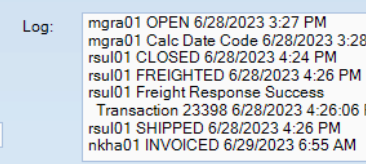

I make a log of all of the status changes and have some in ShipHead Intrans DD and some in CustShip.UpdateMaster. It was a decade ago when I set them up in E9, so I am not sure if all of it could not be done in a few DDs now.
I use freighted and unfreighted from Freighted to Closed rather than the shipped checkbox as Epicor does a bunch of stuff when that is checked.
My log looks like this.
