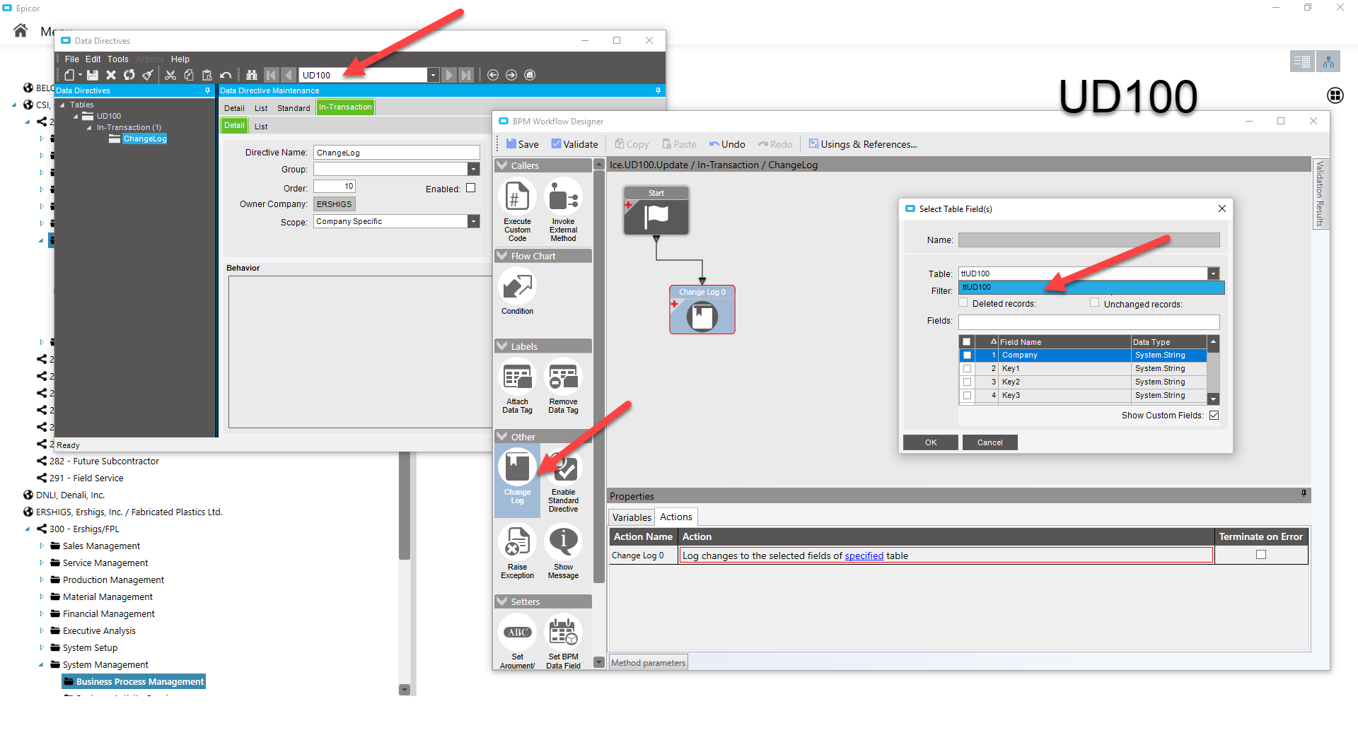

Out of the box the Change Log facility is only available for selected tables in Epicor 9 and ERP 10.
You can however switch it on for any table you wish to track by enabling it through SQL. After you run the following statement, the ChgLog function will be available in the BPM Designer.
– Principal Technical Support Engineer at Epicor Software
UPDATE [Ice].[zDataTable] SET ChgLogId = 'UD100A', TableLabel = 'UD100A' WHERE [DataTableId] = 'UD100A'
Please note that this method only enables the option in the Workflow Designer, it will not add any display option to the maintenance screen; that would have to be done via customization, only if you need it.

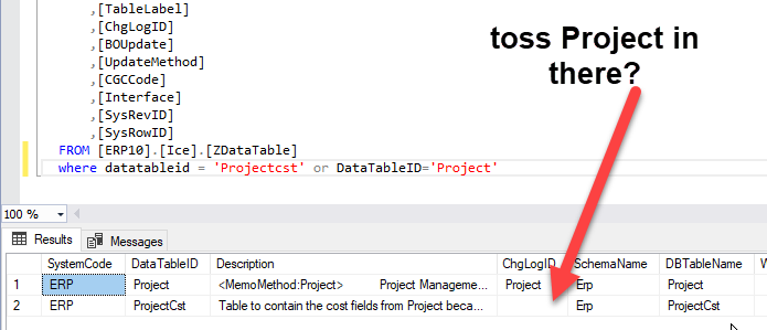

I followed the information on the steps to get the widget to show up on projectcst table and the information is not showing in the change log information screen the button is already there and the information is in the table not sure what I am missing currently.
Hi Devin,

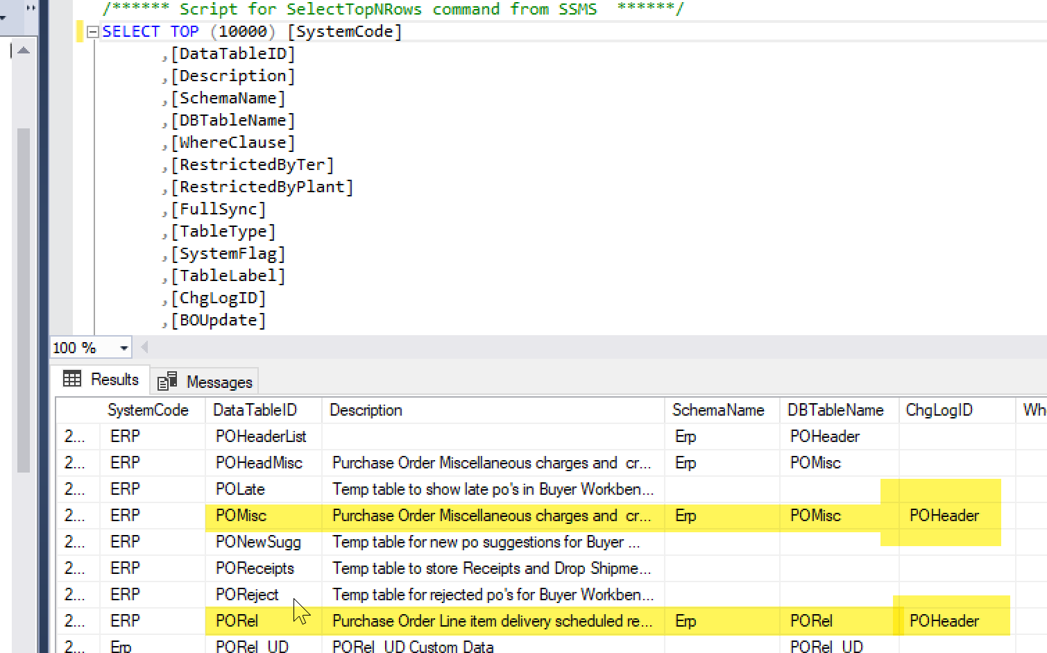

I am not sure if I completely understand your question. But, if it is why don’t I see my changes made to my table now that I’ve set it up for audit? Then maybe it is the ChgLogId field in the zdatatable that shows what data is shown when audit log is clicked in a program. See below screenshot, the reason why PORel and POMisc data changes show up in PO change log when clicked.
I suggest you look at the ChgLog data overall via BAQ to see if your changes are being logged, then look here if it’s not showing up in expected record.
Nancy
my information is showing in the change log table currently in sql for project cst but not showing when I click the change log Icon in project entry.
I wonder if you have to register the View on the Form… Which means also sometimes the Button will only work if you go to the Cost TAB.

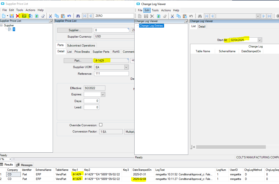

I attempted this for Supplier Price Lists. Change Logs are being written in SQL. I was able to get the Icon to show in the form but its empty. The little star even shows that changes were made but nothing there.
 new ChangeLogHelper(this.SupplierPriceListEntryForm).AddViewToWatch(this.oTrans.Factory("venPartView"));
baseToolbarsManager.Tools["ChangeLogTool"].SharedProps.Enabled = true;
